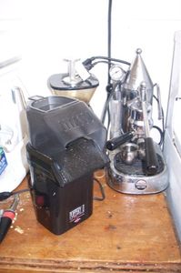

Some poppers will work better than others, but the only detail is that absolutely necessary is air vents that are on the side of the popper, not the bottom of the chamber. See the picture for an example of side vents.
We've had successful roasts with the Poppery I & II, Kitchen Gourmet (Walgreens) brands, but there
are many others. Old popcorn poppers will sell on eBay for $30 ---- that's often because folks are willing to pay a premium to use them as coffee roasters.

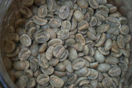

Step 1: Aquiring Green Beens
Finding green coffee beans is not as hard as you might think. Coffee shops that roast their own are usually happy to sell to you, most will do so at half the cost of roasted beans. You can also find them at some health food stores (Rainbow in SF) and online. The going rate for good quality specialty green beans is about $4-7/pound, though it will be lower if you buy very large quantities and a lot higher if you're interested in super premium or usual coffees (cup of excellence, Kona, Jamaican Blue Mountain, or even Kopi Luwak).

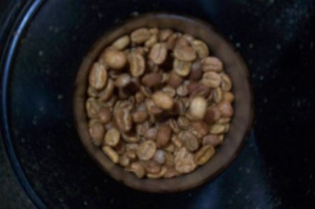

Depending on the size of your popcorn popper you'll want to add between 1/2 cup and 3/4 cups of green beans. The idea is to get them to bounce around so they roast evenly. Start conservatively and move up. The roasting process doesn't take long so you can always do two roasts back to back.

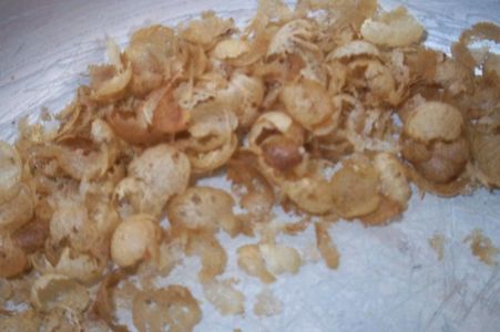

Put the top on your popper, a bowl in front as you would to catch popcorn. This is going to catch the coffee skins, called chaff, that will be expelled as you roast. Chaff makes great compost, especially for plants that like acidic soil. Sometimes it also likes to fly around and you'll find it in your hair later in the day.

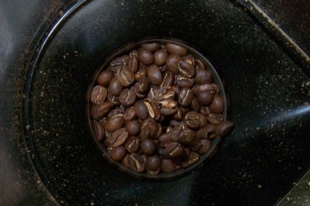

You can remove the lid of your popper to take a look at your beans, stir them around if you wish. Over time they will get darker and darker, after you leave them in long enough you'll start hearing a 'pop' noise. This is called a ‘crack,’ your beans should roughly double in size. If you leave the beans longer they will experience a second crack.

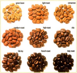

Some varieties of coffee are better lightly roasted, others dark -- most will include some information on this or you can ask your local coffee shop. Everyone has their personal preference, so it's really up to you! Darker roasts have a stronger ‘roast’ flavor while lighter roasts preserve more individual bean flavor. Experiment!!
(See Roasting Table attached at the end of this document for more specifics on different roasts, wikipedia, or Sweet Maria's pictorial guide)

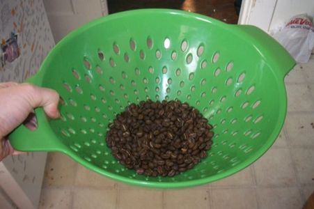

After your beans roast to your desired darkness, cool them quickly by dumping them into a colander and shaking things around until they're room temperature. Congrats, you have somewhere between 1/4lb & 1/2lb of home roasted coffee!
Leave out for 12 hours (to release CO2 from roasting), then seal in an air tight container for storage. Coffee typically tastes best 24 hours - 72 hours after roasting, you might be inclined to try it immediately, but it won't have the full flavor. Over time and some experimenting you'll see how the flavors rise, develop and fall. Happy roasting!
