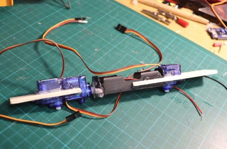

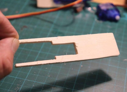

Step 1: Prepare Servos and Body

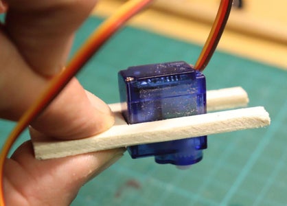

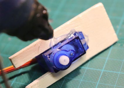

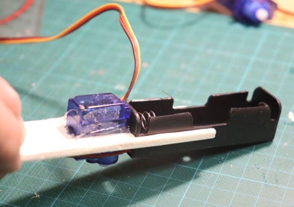

We remove the mounting tabs on the servos so we can glue them together in a better way. The servos front and center are glued together. From plywood (or craft plastic) we saw a small platform on which the ESP8266 will fit.

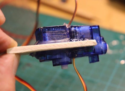

We glue the rear servo together with the battery holder. We put the rear plywood platform on the servo and glue the mount, servo and platform together.
Step 2: The Center of the Body
It would be good to connect the middle servo to a Wemos D1 already to set it to center (90).

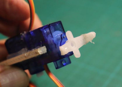

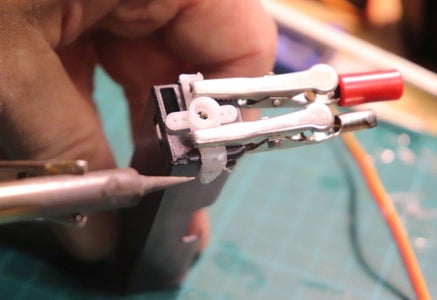

I bent the servo arm for the middle servo a little with the help of the hot soldering iron, so that it "grips" the battery holder. We mount this servo arm to the servo with the corresponding screw, then we glue the whole thing to the battery holder.
The body is now almost finished.

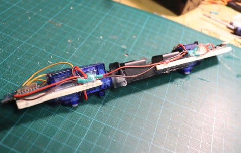

Separate the servo cables into individual cables.

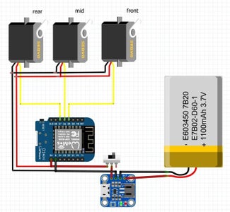

Connect the plus (red) and minus (black) of the battery to the charging module, middle contacts B = battery.
Attention: A slide switch should be added to the plus cable. Later we glue the switch between the servo and the charging module with a few pieces of wood.
From the charger module we connect the motors and the Esp8266 with a parallel circuit. We connect the outer loading module contacts + and - with +(red) and - (brown) of the rear servo. From here we connect the middle servo and from this again the front servo. Finally we connect the ESP8266 to GND and 5V.
We solder the data lines (orange) of the motors directly to the Wemos.
front --> D7 (14)
middle --> D6 (12)
rear --> D5 (13)
After that you can glue all loose cables a little bit to the body.

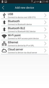

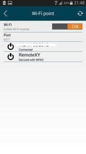

Step 6: The App

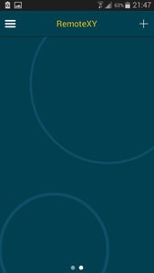

Download the app "RemoteXY: Arduino control" (it's free!) from GooglePlay or other shops and install it on your smartphone.
Power up your Wemos D1, start the app on your smartphone and you see an empty panel.
  • Press "+" to add a new connection.
  • Press "Wi-Fi point"
  • Choose "RemoteXY" from the list.
  • Enter password "1234567890" - not very fancy, I know

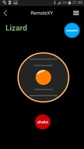

Now you can use the remote control for your robo-lizard. Stop! Mount the legs first.

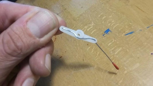

Step 7: The Legs

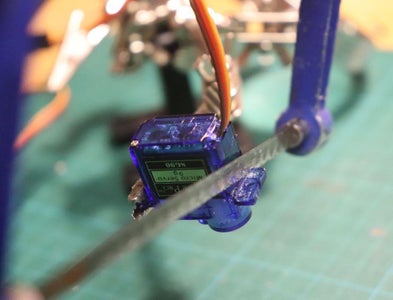

Thread wire through double servo arms as shown in the picture. Cut the wire legs on each side to exactly the same length (approx. 6 cm + 1cm).
Fold the last centimeter of the wire to make a foot.

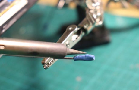

Cut four10 mm long pieces of heat shrink tubing and put them over the feet, the tube must protrude a little. Shrink the tube with the hot soldering iron.
Mount the legs to the servos, check that the legs are the same length and shape on each side.
