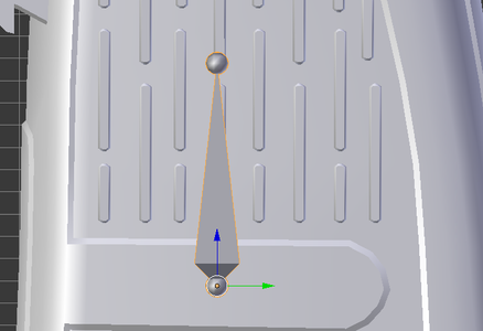

Now, hit shift+a to bring up the add menu, and select “armature, single bone” to add an armature bone to the scene, although you shouldn’t be able to see it right now. That’s because we need to enable x-ray mode. To do so, in the menu at the right choose the Armature tab (the icon with the little man in T-pose). And click on the checkbox that says “X-ray”. Now you should be able to see the little bone we just made, a little teardrop shape with a ball on either end (referenced in figure 2-f). We need to add a few more bones to this armature, but first we need to name this bone, enter edit mode and then click on the bone tab on the right (the icon with the bone by itself).
The dialog box at the top of the menu should say “Bone” click on that text, delete it, and enter “Handle” instead, since this is the handle bone. We then need to create bones for the Trigger, slide, and slide door. To do so, exit edit mode, select the object you’re going to add the bone for, press shift+s and choose “cursor to selection” and then reselect the bone, enter edit mode again, and press shift+a again to add a new bone at the location of the 3D cursor. Then select that new bone and in the tab at the right give it the name of whatever object it will be moving “trigger, slide, or slide door”. Repeat that process until all three other objects have their own bone!
One thing we’ll need to do before moving on to the next step is move the trigger bone. The trigger rotates instead of moving, so we need to move the bone to the top of the trigger so it’ll act like a rotation joint for the trigger. Select the trigger pbone and press g to move it, and place it above the the trigger, right where it intersects the gun model, and left click to place it there.
So now we have all those bones but currently they aren’t attached to each other, which means that everything still moves by itself. We need to parent each bone to the handle, so that when the handle moves, everything else moves with it. To do that, select a bone and shift select the handle bone, press ctrl + p to bring up the parent menu, and choose “keep offset” to parent the bone without moving it. Do that for all three bones.
Awesome! So now our armature is completely connected, and moves together the way it should. Now we just need to parent the model pieces to it, so they move too! Press ctrl+tab to enter the rig’s “pose mode” which will allow us to select individual bones and attach mesh pieces to them!

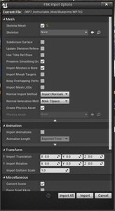

Now, currently you should see a Blueprints folder. If you open it, there’s a weapons folder inside, that holds your mod’s weapon blueprint. We’ll be using that later but for now, back in the content folder, right click on an empty space in the content browser and select “import to *insert folder name here*” then find our fbx file and click open.
This should bring up a new dialog in UE4. It has a lot of options (check figure 3-b), but all we need to do is click the box named “skeletal mesh” to check it, and then click “import all” to import the mesh, it’s physics asset, and it’s skeleton (the armature we created in Blender). It’ll pop up a message log, just close it.
Now you can see we have those three new items, but they all have a small grey star in the lower left corner of their preview images. That means they aren’t saved. We need to save them so we don’t lose them when we close the app. To do that, double click each one to open their window and hit save on each one. Then back in the content browser, choose import again, find both images we need, and import them, saving the same way we did the mesh items. You can close the textures when they’re saved, we don’t need those windows.

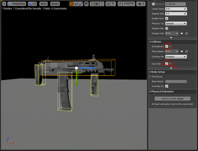

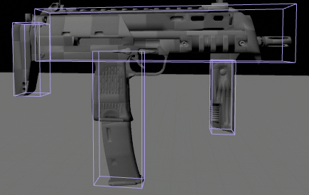

The next thing we need to do is edit the physics asset so it will work correctly for robo Recall. Go to the physics asset’s tab.
When you first open it, you’ll have to move the viewport and you’ll see the entire gun is surrounded by pill shaped purple lines. Those are the guns’ current hitboxes. We don’t want pill shaped ones or the gun will never stop moving, so in the heirarchy to the left of the viewport, right click “Armature” and click “delete all bodies below” to get rid of the pills. We then need to replace those pills with a couple cubes. The easiest way to start is from left view in this case, so click the second menu in the top left of the viewport and choose left and then zoom back in.
Then, under handle, should be a component labeled “SMDImport”. Select it and right click and select “add new body”. In the pop up dialog uncheck “orient along bone” and then click the dropdown for “Collission Geometry” and select “cube”. Then hit ok. That should make a box about the size of the gun, but we want this box to just surround the barrel, so click the box with the two arrows in the top right to enter scale mode and scale it until it doesn’t touch the should pad and is only as tall as the barrel. You can also press the w and r keys while the box is selected to go back and forth between movement mode and scale mode to line the box up with the model. Then in the heirarchy, right click and add another box on SMDImport. Scale this to the handle, and repeat until every section of the model has an appropriately sized box in this view.
Now we need to make sure they’re the proper size at all angles, so go back to perspective and scale the boxes to the guns from every angle.
Figure 4-a should be about what it looks like in the end.
The last thing we need to do here is enable collisions. In the menu to the right, there’s a collision section. Check both “Use CCD” and “Simulation Generates Hits”, and then save. (reference figure 4-b) Without "Generates Hits" and CCD on the robots wont detect when the weapons hit them when thrown. You can then close the physics asset, as we won’t need it open anymore.

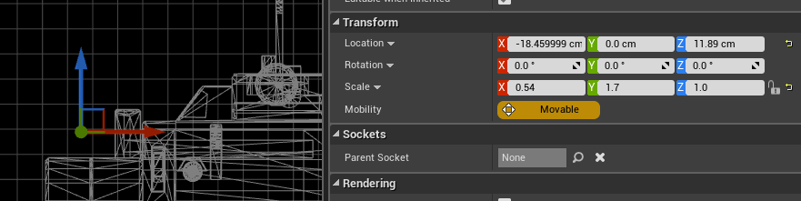

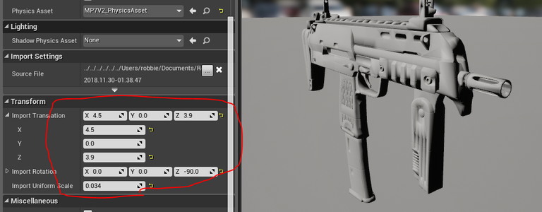

The next thing we need to edit is the model itself. In order for the gun to feel right in the hand, we need to scale it so it’s about the same size as the weapon currently in the game. To do that, we need the mesh itself open (which we already have) and we need to open that weapon blueprint that’s in the weapons folder. When the weapon blueprint opens, make sure you can still see it’s window as well as the content browser. Go back out to the main folder and select your mesh item by clicking it once.
Then, in the mod blueprint ,select the item from the Component hierarchy called “WeapMesh”. When you do, the menu on the right should change to show a new menu, with a category called “Mesh”. Click the arrow to use whatever is selected in the browser as the mesh, in this case our MP7. You should now see our MP7, using the previous pistols textures, in the view-port. However, it’ll be WAY too big, and rotated 90 degrees the wrong direction. To fix this, and change the import settings. (Figure 4-c displays all recommended import changes.)
Now that our weapon is the right size and in the right place, we need to make a slight change to it’s skeleton so it will shoot bullet casings out the side. Go to the skeleton window, and zoom in on the model. We need to create what’s called a socket. A socket in UE4 is essentially a point on an armature that you can attach other objects to.We need one on our main model (main so it doesn’t move when the slide or trigger moves) so select the Handle, right click, and choose “Add socket”. Name the socket “Shell_Socket” (this is important, because it’s the name of the Socket that the shell component spawns at) and hit enter to make it!
Now currently it’s much too big, and it’s in the handle instead of inside that opening for the bullet casings, so we need to move it and scale it to fit. (again this can be done easier from an orthographic view, front in this case. You'll have to flip back and forth between the skeleton window and the mod window (which you should put the view-port into wireframe mode for) because the bullet casing can be easily seen as a purple outline in wireframe mode.
(Figure 4-d shows transforms for Shell_Socket socket.)

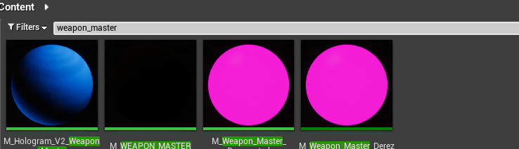

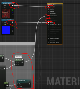

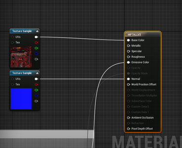

Now our weapon needs its own material. To add one, right click in the content browser and choose Material in the “Create Basic Asset” section.
Name it MP7ALL and hit enter to create it, then double click to open it.
That will open a window with a sphere and a blueprint area with a grid and a brown node that says “MP7ALL”. To use our two textures, drag them both from the content browser into the grid and release them. Then drag a wire from the color texture’s white circle by clicking and dragging and move that wire to the “Base color” circle on the MP7ALL node. Do the same for the normal texture to the “Normal” circle, then hit Save.
(Should look like the connections of the red and blue nodes of figure 5-a.)
Then go back to the mod blueprint and in the slot for materials in the WeapMesh component, hit the arrow with “MP7All” selected in the content browser to apply it to our weapon. It’ll take a few seconds to change in the viewport (when it finished, it should look like figure 5-b). Make sure to compile and save both the mod blueprint, and the MP7ALL texture, and then we can click “Play” in the mod blueprint (or the main window’s menu) and put on our headset to try it out for the first time!
Once you load the mod into your active mods section in the main menu in the test level, you’ll notice a few things:

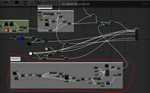

The next few steps will cover the fixes for all of those! For now, we’ll focus on making the gun dissolve. Dissolving is handled by a material that the devs for Robo Recall created, and we just need to copy the nodes from that material into our own material for dissolve to work. In the content browser, scroll up to the top of the folder view and select the content folder. This houses all the things the software uses to make mods. Now in the content browser, search for “weapon_master”. A material called M_Weapon_Master should show up. Double click it to open. (refer to figure 5-c for clarification.)
We’ll need to zoom out to see all the different parts of this. There should be a box called “Dissolve” (referenced in figure 5-d). Left click and drag a box around that box to select it and everything inside, and then copy it.
Then quickly exit out of that material, without saving, as we don’t want to mess it up.
We then need to paste what we copied in our own material. And move it so the right end is next to our MP7ALL node. There should be two nodes at the far right of that box: A Multiply, labeled as Hotline, and the UseDissolve node. Drag a line from Multiple to Emmisive Color on MP7ALL and drag a line from UseDissolve to OpacityMask on MP7ALL, and save. (referenced in figure 5-e)

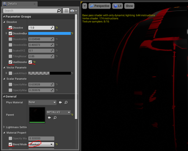

Now that added all our dissolve code, but we need to activate it. To do that, right click the MP7ALL material in the content browser and click “create material instance”. Then change the “Inst” to “Dissolve” (or leave it, it doesn’t make any difference) and hit enter to create a material instance. Then open it.
In the new window, on the left, is a menu with several disabled items. We need to enable 4 of them:
(referenced in figure 5-f)
Dissolve
dissolveBurnColor
Use Dissolve and it’s secondary checkbox
And Blend Mode
Once you have all of those enabled, change the Blend Mode in the dropdown to Masked and hit Save. Then wait for the popup in the right bottom corner that says “Compiling shaders” to finish and save again. Now if you click and drag across the numbers for Dissolve, you’ll see a blue light fade across the material and hide it. Make sure to set Dissolve back to -1 and save and exit. (you can use the yellow arrow to the right of any changed variable to reset it to it’s default.)

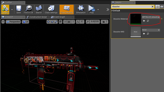

Now back in the mod Blueprint, go to the MP7_V1Pistol(self) component and search for “dissolve” in the menu to the right. Then select the instance in the content browser and hit the arrow next to “Dissolve Material” to use that instance as the dissolve material. (referenced in figure 5-g) Then compile and save, and if you choose to test again, like I will, you’ll see that once the gun is out of ammo and you drop it, it will dissolve away like the guns in the base game. And that’s it for our Material, it’s completely done now!

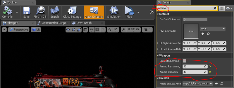

So in the top right menu in the self component, search for ammo. Youll see that both Ammo Remaining and Ammo Capacity are currently 20. Ammo Remaining is the ammo left in a weapon grabbed off a defeated enemy, while Ammo Capacity is the ammo in the weapon you spawn at your belt. Change those both to 40 and save if you want more ammo in your weapons. (referenced in figure 6-a.)
Then search for refire. There should be an option under the Weapon category called Auto Refire. Check it’s box so the weapon will fire in auto mode. We’ll also want to change the Refire Time to .063, the time it takes for an actual MP7 to fire on average (used some math from the wikipedia article on MP7’s to get that number). Then compile again. (referenced in 6-b.)
The last thing we want to search for is recoil. In the Default category, there should be an option called “Dynamic Recoil”. This is the multiplier for how stable the weapon is. Since it’s an smg and we want it to fire pretty straight, something from .3 to .4 would work fine there. Then compile and save again.

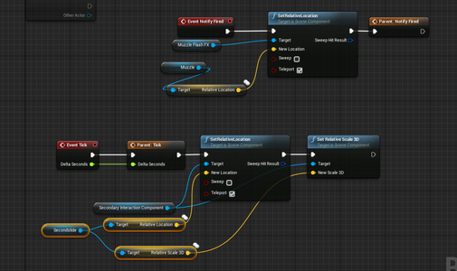

Now if you test out the mod, it’s looking much better, but there’s two things left to fix. The animations, obviously, but also out muzzle flash is still inside the gun. To fix this, we need to create a new component for Muzzle flash to move to on the weapon. Go into front view and with the self component selected, click the Add Component button and choose Scene. This will create an empty object with transform values but no geometry so you wont see it in-game. Name it Muzzle. We’ll use this object to move the MuzzleFlashFX component inside Blueprint.
Using the arrows, move the Muzzle component so it’s three or four blocks in front of the barrel from front view, zoomed in to the 10cm mark. While zoomed in all the way. (or in the menu to the right, set the transform location to 37.38, 0, and 6.97) (referenced in 6-c.)
Then click over to our Event graph. This is where all the code for our mod will go. We want to move the muzzleflashfx component only when the gun is firing, so right click in an empty area and search for Event fired and choose Event Notify fired. Now currently, this node we just created would stop the gun from firing entirely. To fix that, we need a call to it’s parent function. Right click on the new node and select “add call to parent function” and it will add in a orange Parent:Notify Fired node. We’ll connect those two up later, but for now, drag the MuzzleFlashFX component into the Blueprint Event Graph.
This will create a reference to the object we need to move. Put that node close underneath Notify Fired and drag a line out from it’s circle and search for “Set Relative Location” to get a node that can move the MuzzleFlash FX component. Now we just need somewhere for it to move to! Drag in a reference to Muzzle, then drag a line off it’s circle and search for “get relative location” to get an orange node that represents the Muzzle empty’s location in space! Then connect the output of that new node to the orange input of “SetRelativeLocation” so that MuzzleFlashFX will move to muzzle’s location! Also check the box next to “Teleport” so it moves there right away, not over time. Then connect the output arrow of Event Notify Fired to the Input of Set Relative, and the output of Set Relative to the input of Parent, compile and save. Now when you test it out, the muzzle flash should come from the right spot. (all code referenced in figure 6-d.)

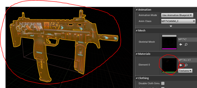

This almost completes our mod! All that’s left is to apply that anim blueprint to our mod blueprint.
Go back to the WeapMesh component in our mod blueprint and search for anim at the right. Anim class should currently have nothing in it’s dropdown. Select our anim blueprint in the content browser and use the arrow next to the anim class dropdown to apply our anim blueprint to it. Then compile and save!

The final thing we can do is something that’s just a quality of use piece. Currently robo Recall has two basic grabbing interactions: One that grabs the gun itself, and a second one that uses the off-hand and can slide the slide back and forth when grabbed. Currently the collision box for the secondary interaction is where the slide for the old pistol was, so we need to move it and scale it so it matches where the slide is and can go now. To do so, we’ll be doing something similar to what we did for the MuzzleFlashFX. With the self component Selected, make a new scene component and name it second. We’ll come back to it later.
Now in front view in the viewport, select the Secondary Interaction Component in the hierarchy and move it to where the new slide is, and write down it’s location (in the menu on the right). You’ll need to know this so we can set the second scene component to that location later ( I found -18.46, 0, and 11.89 to be good). Then scale it so it covers just a bit more than the area that the slide moves. (I found 0.54 in the x and 1 in the z to be fine.) Then go back to perspective and scale it in y so it covers a bit more than the slide again. (1.7 in y looks good to me).
(All transforms referenced in figure opt-a.)
Now, once you have all those numbers down, reset the component back to it’s defaults, and put those numbers in the same places on the second scene component.
Now in the event graph drag in a reference to second and put it underneath the “parent: tick” node. Then grab a reference to Secondary Interaction Component as well. Drag wires off Second and get it’s relative scale and relative location. Then drag wires off Secondary and search for “Set relative scale” and choose the Set Relative Scale 3D node, and connect the output of Second’s relative Scale 3D node to the orange circle on Set Relative Scale 3D. Then drag another wire off of Secondary Interaction Component and search for Set Relative Location., setting it up with Second’s relative location the same way we did the muzzle. Then connect up all the arrow wires, starting at Parent: Tick to Set Relative Scale 3D and then from Set Relative Scale 3D to Set Relative Location. Compile and Save, and now the interaction component should be in the right place and the right size all the time.
(Nodes explained here referenced in figure opt-b.)
