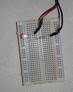

2.1. Glowing an LED (In 3V)
- Put two 1.5V cells in the battery holder in the right orientation (avoid short circuit between red and black wire)
- Make all the connections as shown in the breadboard circuit image
- Ensure the correct polarity of the LED (long leg to the battery positive [red])
- Resistance value is 1K (colour code is brown, black, red, gold)

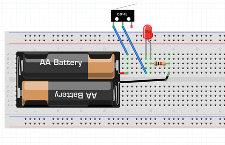

2.5. LED Circuit With Limit Switch
- Here we replace the ON/OFF switch with a Limit switch (limit switch with 2 wires) The 2 wires from the limit switch will make the circuit when we press the switch lever, so it is a normally open (NO) switch. LED will light up when we press the lever and turnoff when we release the lever.

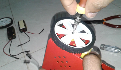

- Take the robo wheel and place it in the gear motor’s shaft
- There is a small screw in the wheel, tight it carefully by the small screwdriver

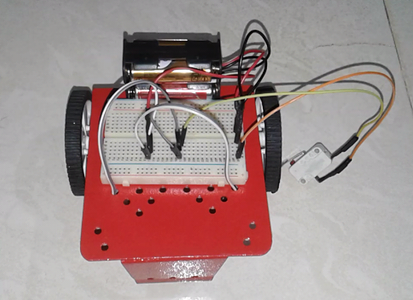

- Connect the two motors in parallel to the battery through the breadboard , connect the same colour wires of the motors together otherwise the motors will rotate in opposite direction
- Also connect the ON/OFF switch in between the battery and the motors (keep in OFF position)
- Check below circuit
- Double check every connections once again
- Test the circuit by turning on the ON/OFF switch
- By changing the battery polarity (interchange the battery wire) you can move the robo car backwards
- Also you can replace the ON/OFF switch with the 2 wire limit switch
