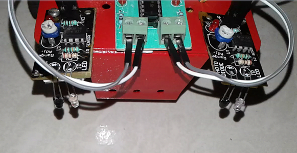

- Remove all the previous project connections and remove limit switches
- Place IR sensor module instead of limit switch
- Fit it by using nut and bolt or use double sided tape
- Take the motor driver module PCB
- Connect the motor wires to the PCB screw terminal using a small screwdriver, do it carefully without applying extra force otherwise it will damage the PCB
- Connections are like white wires to the inside terminal and ash wires are to outside terminals, check the given image (if colours are changed then the motor will rotate in opposite direction)
- Fit the motor drive PCB in the front side of the robocar using double sided tape as given in the image Now the remaining part is the wiring section. Let’s do it….. Wire the circuit based on the given wiring diagram. It is easy to use the same colour wire which used in the wiring diagram and in the real image

- Bend the IR LED and IR sensor in downward direction
- Keep both the sensors little bit outwards with a small angle as shown in the given image

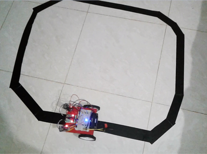

- Make a black line with width of 4c.m (line width must less than the distance between two wheels); you can use black coloured paper or black insulation tape. You can make your own shapes. Here in this case it is a round loop. So the robocar move in a loop continuously. Avoid 90 degree sharp bends.
For proper working you want to fine tune the IR sensor module sensitivity. You tune the potentiometer for satisfying the given conditions.
- IR module give output (red LED on) when it faces the floor other than the black tape
- IR module never give output (red LED off) when it faces the black tape
Theory: When the sensor detect black surface (no output), that side motor will stop and try to again move away from the black surface. In this way the robocar try to maintain both the sensors give output (red LED on) by keeping the black line in between the sensors.
