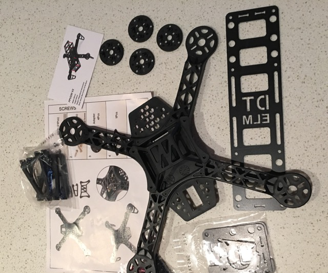

Step 3: Carbon Fiber Quadcopter Frame
Carbon fiber chassis feels rugged, lightweight. It has a thickness of 1.5mm thick fuselage and 3mm thick arms for better support
the power from motors . In the videos you can see a fast assemble and all parts received in a single pass.
Step 4: Assembly of the Robo
Hardware is very easy to identify it comes with not instructions, but however leave an image that came to me very well for the Assembly of the Robo.
Patience at the time to assembly It is also recommended, above all if it is the first time that you mount something,
