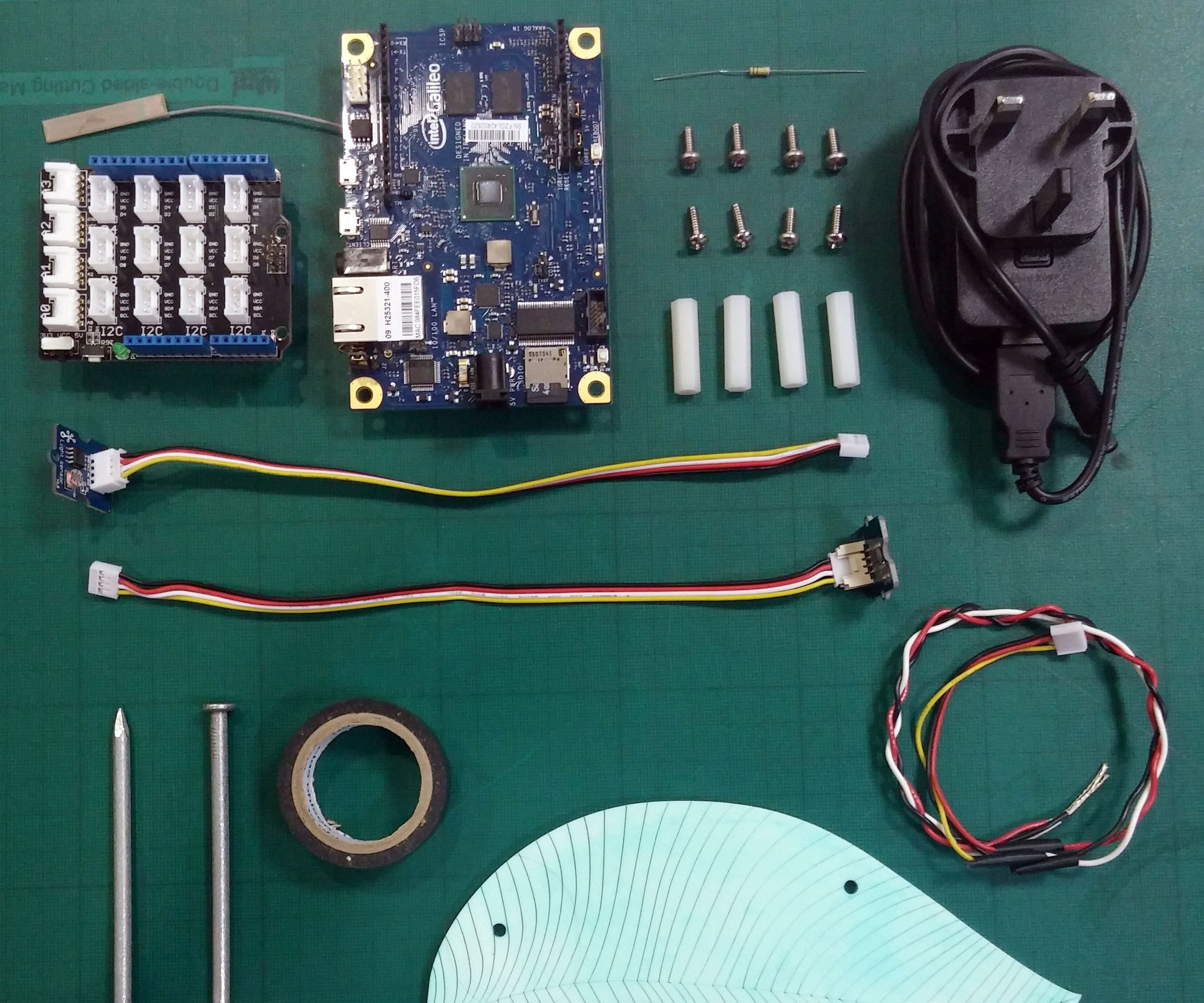

Step 2: Unpacking Your Kit
In your RoboTug kit you'll find the following:
- Laser cut acrylic acrylic casing
- Intel Galileo with SD card and WiFi card
- Power source
- Linear potentiometer
- Screws and mounts
- Springs
