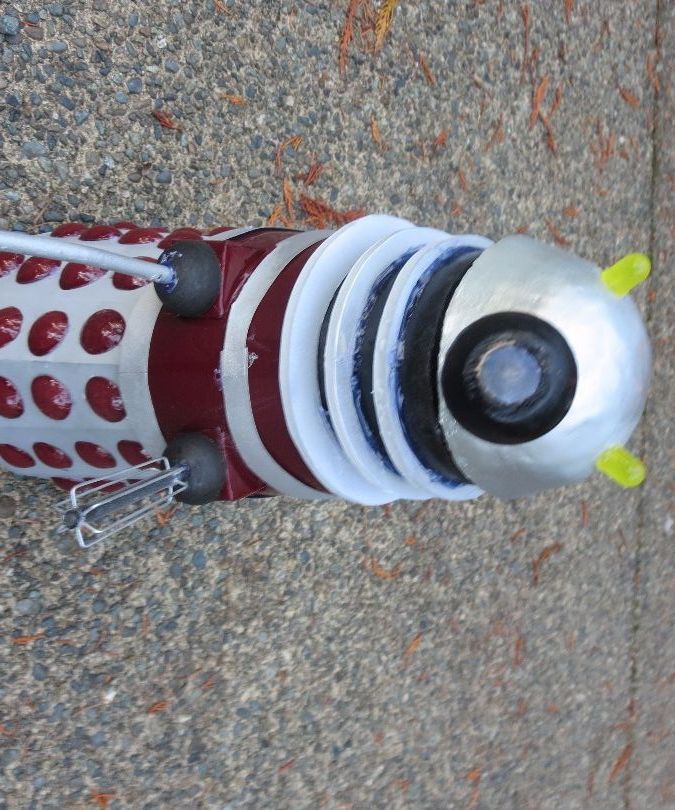

Step 7: The Antennas
Start by cutting a 1 1/2" piece off a paper clip, then wrap enough electrical tape around the piece of paper clip about a 1/4" from the end so that a pen spring will snugly fit on it and then put a pen spring on the electrical tape so it that the end of it is about 1/8" past the end of the piece paper clip. Next cut a 5" peice of 32 awg enamel wire and sand the enamel off one end and wrap that end through the end of the spring and solder it in place. After that, strip the insulation off about 3" of 22 awg wire and wrap it around the bottom of the spring. Then solder a piece of wire to the bottom of the paper clip and to the piece of wire wrapped around the bottom of the spring. Next wrap electrical tape around the end of the paper clip with the wire soldered to it and then wrap electrical tape around the part of the spring with the wire wrapped around it. Repeat for the other antenna. After that drill 1/4" holes on the front of the shell(see pict 8). Then insert the antennas through the holes so that the part of the spring that is not on the electrical tape is sticking out of the hole and then hot glue the antennas in place from the inside of the shell. Finally, attach the wires from one antenna to the corresponding wire on the other antenna and add a small piece of 22 awg wire to the two connections and solder.
