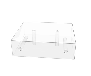

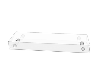

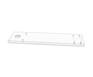

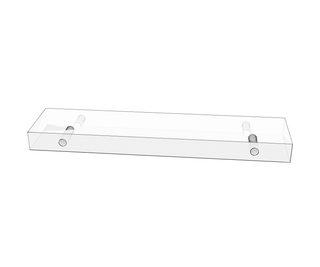

Step 1: Fabrication Robot Arm

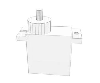

For the first step you have to make the parts for the robot arm. For this we use two pieces of 120x35x4 mm made of plastic. You can make these parts with a laser cutter but I have made them by myself with a jig saw. These plates are quite easy to make and because of that I chose to do it by hand. In both of the plates there has to be drilled a hole of nine mm so the servo mount fits in it. Then there will come two holes of 1 to 2 mm in it on the basis of the servo mount. This ensures that the plate can be attached to the servomotor. By one of the plates there has to get drilled another four holes of 2 mm to attach two other blocks of 35x30x10 mm wood.
These wooden blocks I have also sawn but this time with an ordinary handsaw. After this the same holes has to be drilled in it so it can be attached to the plastic plate. In both blocks there has to be drilled another two holes so you can attach the robot gripper. In one block the two holes has to be drilled trough all and the other has to be drilled only 5 mm deep.
Then only the micro servo has to get attached to the robot gripper, but this won’t fit directly. Because of that I glued it all together with a glue gun. To make sure it won’t fell of I also tie wrapped it.
After you made all things it is wise to do a quick test fit because then you know if everything which you have made is good enough.

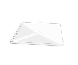

Step 3: 3D-printing
Because I have to use at least one part which is made by a 3D-printer I have chosen an appropriate part for that. This part is a square plate of 50x50x5 mm PLA. This will be attached on the base servo which turns the whole arm. On top of this plate the servo which functions as a shoulder will be placed.

Because the servo’s can’t run on the power which is been given by the Arduino-board, I have applied an extra power supply. This power supply contains four batteries which deliver 6V and about 8000mAh.
Beside this it is essential that every servo is strong enough to turn the specific piece of the arm. Therefore I calculated how strong every servo has to be. The calculations can be found in the added file.
