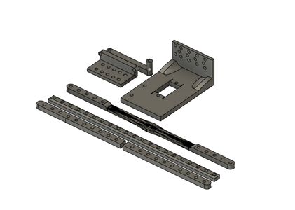

Step 1: Printing the Pieces
This is the compilled version of all the parts neccessary to produce this project. I will also provide individual files so if one would like they can modify and optimizie the pieces for their own liking.

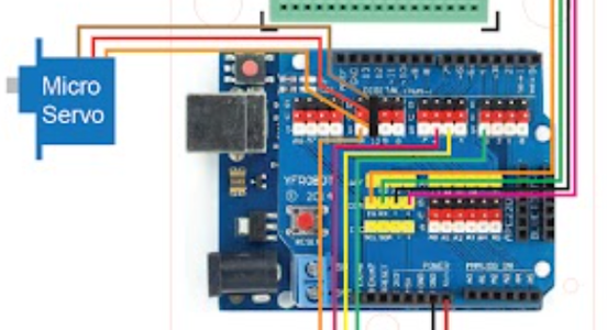

Step 2: Wiring the Servo
For the arm to actually work, the servo has to be up and running. To ensure this, we will plugin and test the servo before beginning to produce and put together the attachment robot arm. To do this we will need to plug in the three pins of the servo into the G V S slots on the 10 pins. The orange wire on the servo will plug into the white terminal on pin 10. The brown wire will plug into the black terminal on pin 10. The red wire will plug into the red terminal on pin 10. Once connected to the robot, ensure your robot is connected to your dabble remote via your device and test out the servo movement.
Steps:
  • Orange wire to white terminal on pin 10
  • Brown wire to black terminal on pin 10
  • Red wire to red terminal on pin 10

Step 4: Attaching the Arms to the Base
After printing and/or modifying the pieces provided, it is time to start assembling the attachment.
Steps:
  1. You will need to find the Base, this is the large pieces with a slot for the servo and holes to bolt down. An image of this piece will be displayed above.
  2. You will need to locate the two attachment arms, these are 2 long, identical pieces that have 10 holes for attachment purposes. An image of this will also be provided.
  3. Now you will need to grab two of the medium length screws as well as two nuts two hold them tightly.
  4. Before screwing on the pieces, ensure that the arms are attached through the front side, the side with the piece extending out on the bottom with the 14 screw holes.
  5. Now you must screw through the first hole on the circular end of the long piece and further screw it into 1 of the two holes on the large face of the base. There are two designated holes 10mm away from each other that are allotted for the arm pieces.
  6. Next you will screw in the other arm with the same process.
  7. Once the arms are screwed in, you will tighten them on with nuts to ensure they do not fall off while in movement.
Onto the next step...
