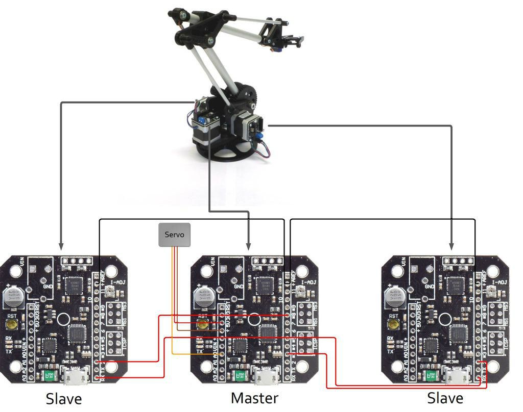

The three uSteppers are connected as shown here on the diagram. One uStepper is master, receiving data through the UART and distributing this to the two slaves.

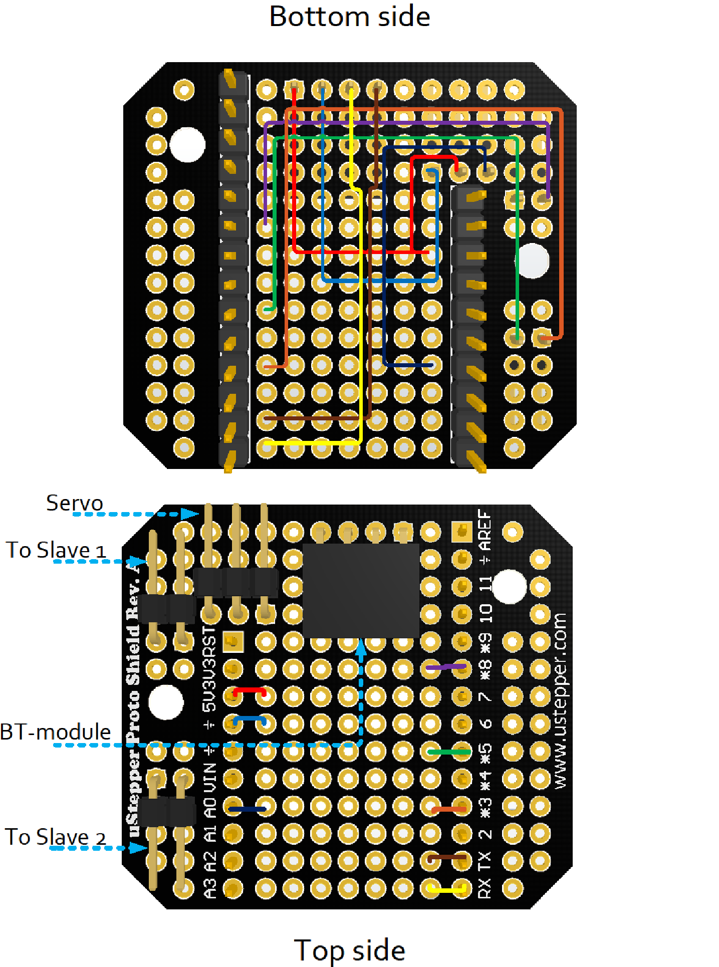

To make it easy, I used a prototype shield on the master so that I could easily connect bluetooth module, servo and slaves.

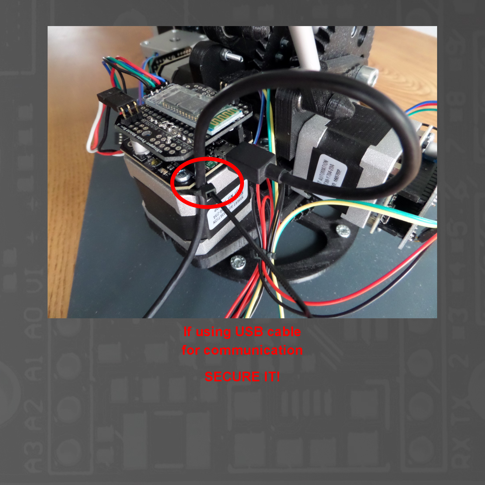

If using USB cable for communication, it is essential that it is secured properly to avoid breaking the USB on the uStepper when rotating the arm.
