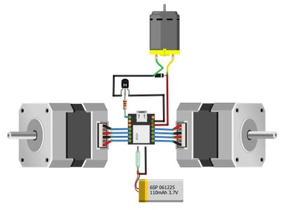

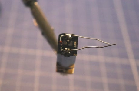

The bacterium has no reverse gear. So you can do without an H-bridge and operate the motor via a transistor and the power supply of the microcontroler. To slow down the fast motor I used the PWM method.
If the axis of the motor has a gear wheel, we simply put on the holder for the binding magnet and fix it with super glue.
Later, we only have to attach the magnet with the drive tail to the right place on the outside of the shell.

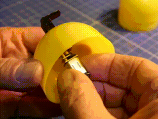

The ring has a diameter of 6.7 cm and can be easily pushed into the egg later. In it all the parts are fixed. Holes have been made for a lightweight design.
Step 3: Gimbal Joint
To move the motor and therefore control our bacterium we need a gimbal joint. It consists of two plastic rings that allow us to tilt the motor right/left up/down.
Gimbal Joint and control unit (step 4) are placed in the 3D-printed ring that is simply inserted into the egg body.

With the two stepper motors we control the direction of our drive. The motors are controlled each via 4 pins directly on the microcontroller, we don't need a controller chip!
An ESP32-C3 is just enough for this: 2 x 4 pins for the stepper motors, 1 pin for the transistor of the drive motor. 2 pins would remain for LEDs or sensors.

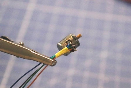

First, solder four wires to each stepper motor. Use a flux, this makes the difficult soldering easier.
After many experiments with homemade and purchased solenoids (too heavy or too weak) or servos (too big) I returned to stepper motors. The micro version is just suitable for our purposes and quite cheap.

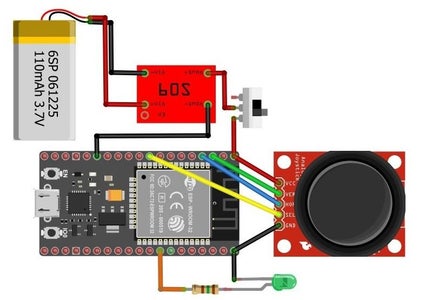

As remote control I use an ESP32 with joystick and the protocol ESP-Now. It is simple and effective and has a higher range than normal wifi.
You can find a simple building instruction here.
[Of course you can also use the BLE function or normal WiFi of your ESP32-C3, but I won't go into that here.]

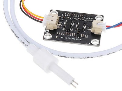

if I make it in this smallest space, I would like to add a TDS sensor to control the water quality, indicated by a LED in the bacterium body.
