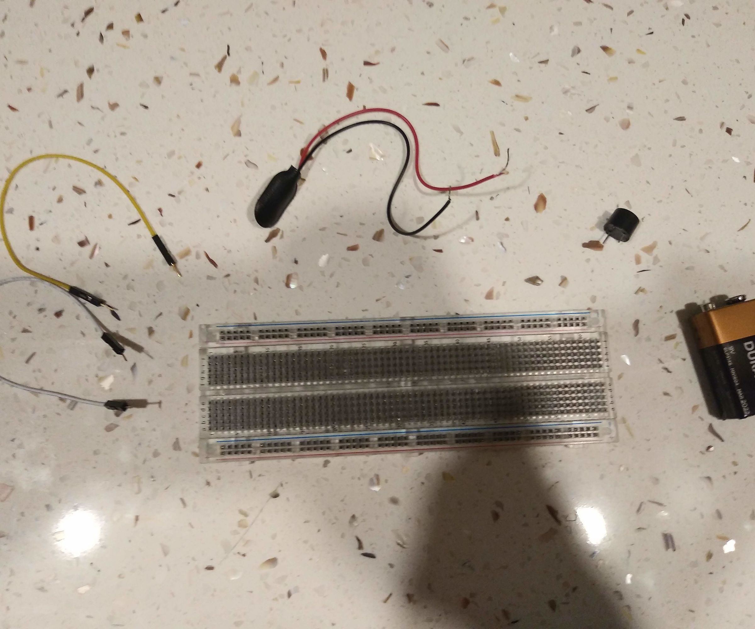

I have decided to create an instructable that demonstrates how to create the Robot Bumpers and how to place them on the Battery-Controlled Robot. Firstly, you want to ensure that you have the wires connected in the right places. The circuit will not work otherwise. Secondly, you want to ensure that you have one of the wires connected to the VDD (positive) and the other wires connected to the VSS (negative). Lastly, you want to ensure that you connect both of these wires to the tin foil. The very last step that you have to do is ensure that the tin foil is connected to the bumpers.
The supplies that were used to create this Instructable were the following:
- Two Sticks
- Tin foil
- 3 Wires
Step 1: Placing the Foil on the Sticks
Place the two sticks on the back of the bumper, ensuring that both sticks are covered with tin foil. The best option to ensure that both sticks stay on the back of the robot would be applying a small piece of adhesive tape.
Step 2: Connecting the Wires
In order for your circuit to work, you need to be able to connect the three wires from the VDD and VSS to the tin foil-covered sticks.
Step 3: Connecting All the Wires Into One
Lastly, in order to get all of the wires onto the bumper to start working, wrap them with tin foil and press them onto the foil-covered sticks. When pressed, the current from the wires caused the robot to move.
Step 4: Watch It Go!
When you press all three wires to the bumpers, the car should start moving. The next step displays the code that was required for this to work. The program that was used for this process is called "Basic Stamp Editor".
