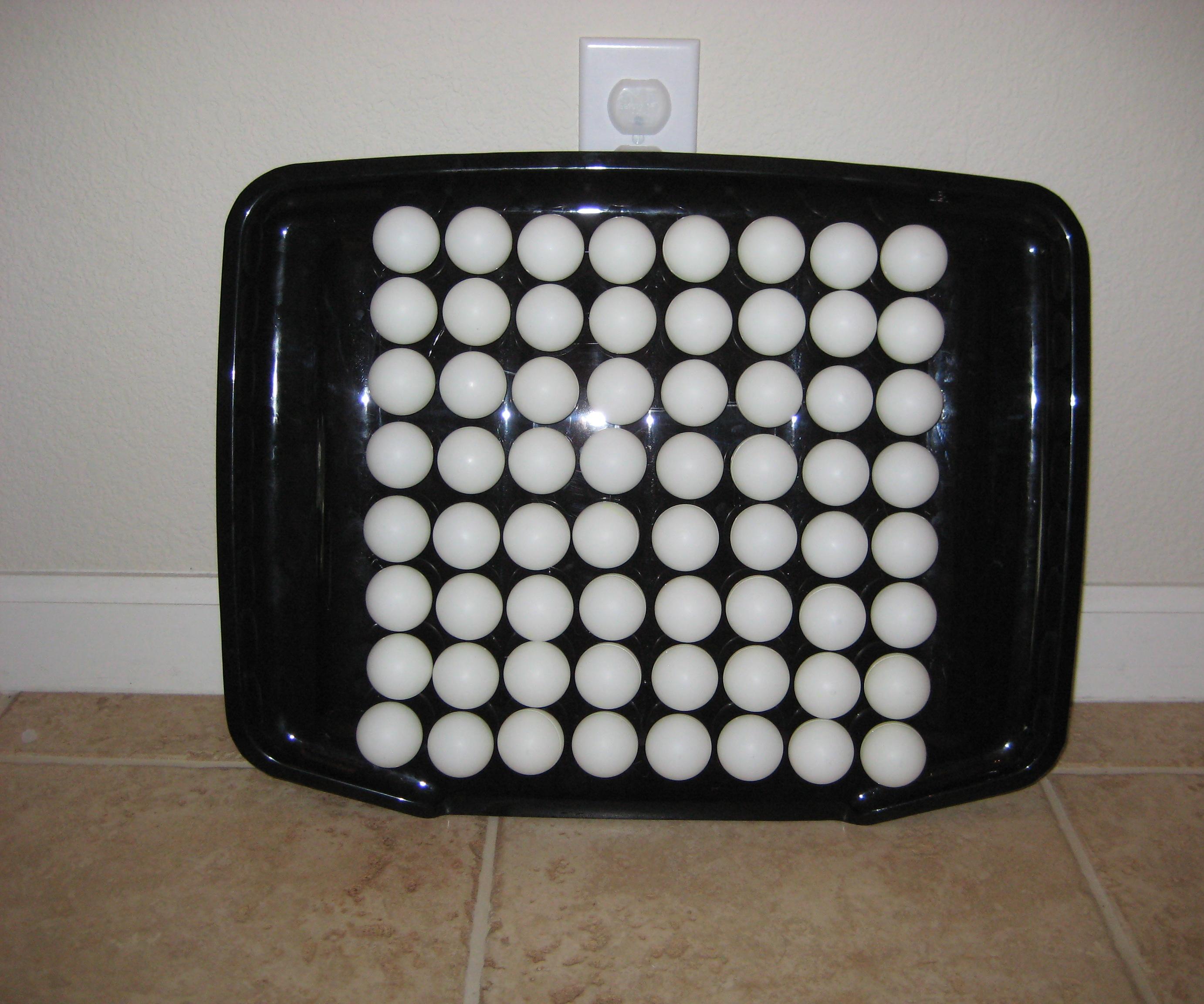

I bought a battery powered push light. You could use it as is, but I decided to add a bit more of a light display. I bought some Neopixels and an Arduino from Adafruit. There are some great tutorials over at Adafruit. The Neopixels are RGB LEDs with built in controllers and then the Arduino is used to animate them. Time was limited so I just used the sample code provided in the Adafruit. Attached is a PDF of the template I used to cut holes for the Neopixels.
I chose a location in the front of the torso to place the light. I used some 3M Command Strips to mount the light to the front of the torso. I cut a small square in roughly the center of where the light would be mounted so that I could pull and release the strips later. A little above that I cut a small hole to pass the wire that connects the Arduino to the push light.
I created another cardboard pocket to hold the Arduino and a 9 volt battery inside the torso right behind the light.
