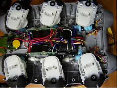

The robot chassis will be taked from a commercial robot toy. This toy has 6 legs and can move forward, backward, turn right, turn left and is radio controlled. An adaptation will be performed, using the mechanism of the robot for strolling and some basic level of intelligence will be added using a microcontroller, sensors, motors and a camera.
A 3D model of the original toy is done using a design software (Autodesk Inventor) and the extra mechanisms are added in the design process. The blueprints of the mechanisms were adquired from the software also and then manufactured
Step 2: Robot Architecture
Here is explained the robot architecture for the control. The electronics for strolling are reused from the robot toy and is connected together with the PIC and the added electronics.
