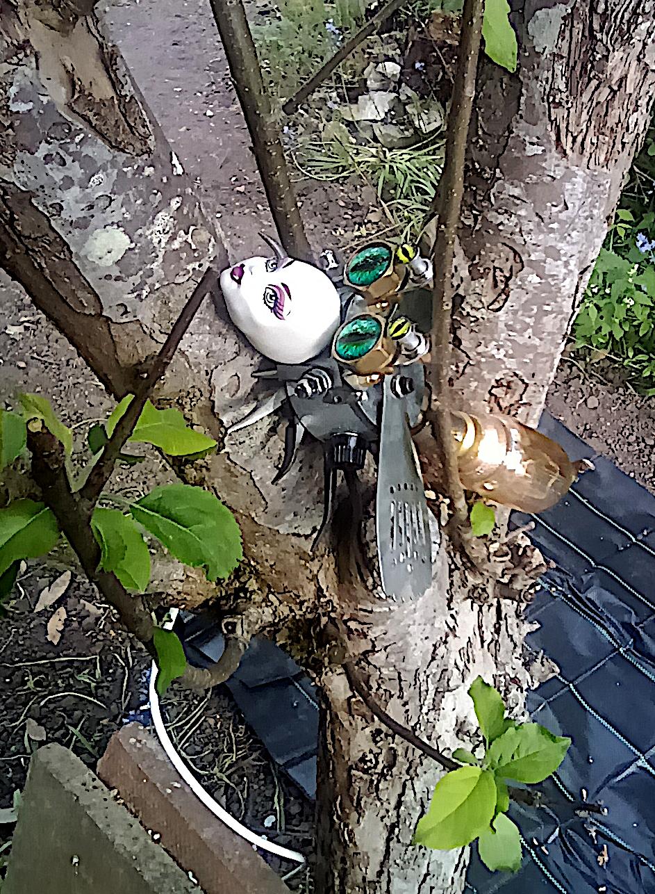

It's probably best to collect together the pliers and make the legs first- you will need these to decide where to drill the holes for them in the main body. I used two each side to get eight legs in total. I used bent pliers for the front legs and some longer needle type pliers for the rear legs. The rear pliers I bent by heating them up first with a blowtorch and then bending them to the needed shape. However, you can use the same pliers all the way around, it all depends on the look you want. Originally I did use just bent pliers but felt the back legs looked too short- a bit like my own human ones. but easier to replace if they look wrong.
Then just hacksaw off the handles close to the joint and drill a hole through the centre of the joint to use for bolting them to the body. I use a 4mm drill as I've deiced to use M4 nuts and bolts as the main standard size for my creations.
Is it just me, or does that bottom view of the legs look like the parasite from Alien? I'm definitely not putting it near my face just in case, plus who wants to go around all day with a mains cable coming out of their mouth?

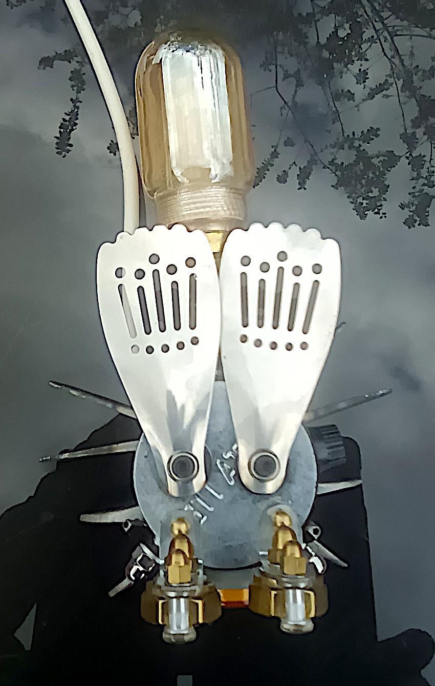

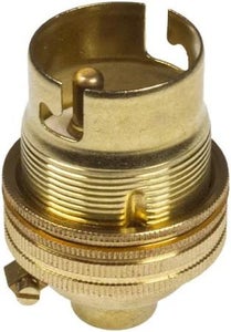

Now it's time for the body! It's best to fit the lamp holder and whatever is going in to the front head bit first. Then, you can see where to add the other bits so holes, nuts and bolts, etc. don't clash. You will also notice that the side pieces on the conduit box are longer than on the finished flyder. I made both shorter, using a hacksaw first and then, in the case of the lamp holder side, a bench grinder to shape it to fit the position of the lamp holder at the rear.
I used a lamp holder with a standard 10mm thread and shortened the conduit box arm in order to use a brass surface mount base. However, depending on what you have handy, you can use a short length of suitably threaded hollow rod with a washer and nut inside. This rod is specially available for light fitting, but make sure it is the right thread for your lamp holder. Modern light holders usually come in M10 and M12 fine thread, older ones in 3/8". All will be ok to use, just make sure that the threads are all compatible on the fittings. You will need to get fine thread nuts for the threaded rod, not normally available M10/M12 nuts as they will usually be coarse thread.

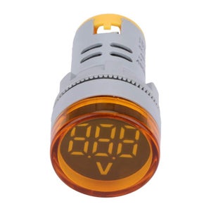

In addition to this being a light, I also wanted it to do something else, though I wasn't really sure what. I did initially think about putting a clock in the front but then I came across AC voltmeters which fit exactly. I simply wired this in parallel across the lamp holder. However, it also gave me something to slide a vinyl doll's head over. LOOK AWAY NOW IF SQUEAMISH OR SKIP TO THE NEXT STEP! I simply pulled the head off a cheap doll and cut a suitably sized hole in the back of the head- I did the doll's trepanning with trepidation. It just then pushes on.
As for why it is showing 247v when we are supposed to have a 230v supply here? In the UK, the declared voltage is 230v but the tolerance is -6% to +10%,which goes higher than most people probably realise. None of your wimpy 110v diet-lite AC here, this is full-strength, give them a good thump if they mess with it AC! Plus I would never have known the voltage was 247v if it hadn't been for my handy flyder voltmeter, forever ignorant of the vagaries of the public AC supply.

The final stage before wiring is simply bolting the bits together in appropriate places. The legs attach to the base, the eyes are then attached to the top lid of the conduit junction box. At this stage you have a Robot Spider (Latin Name: Mechanica Aranea Roboticea). To mutate it it needs wings- I found a cheap pair of salad/spaghetti tongs (similar to those shown) in a local shop and cut the ends off. I'm sure there are spatulas that will also work. The wings have a rubber washer beneath them so they can be repositioned for landing or going hypersonic!

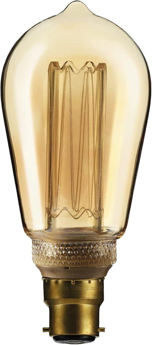

The bulb used should be an LED one as it is bare and you really don't want it getting too hot for obvious reasons. The one I used is more for decoration at 2.5w but still makes a good background light. Made by TCP, it has a really interesting fake filament made by little bubbles in a perspex bottom lit tube, similar to the one shown.
