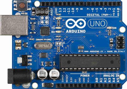

3.Arduino UNO

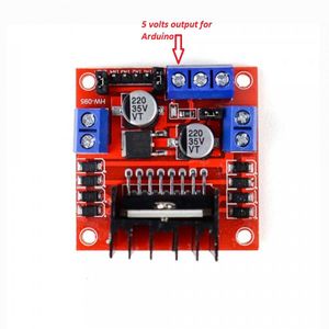

4.L298N dual bridge DC motor

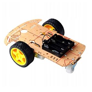

9.Car KIT Arduino
