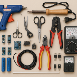

Materials:
1. Several plastic boards (as the robot frame)
2. 2 infrared (IR) sensors
3. 2 5 volt relays
4. 2 7805 IC regulators (to stabilize the voltage)
5. 1 3.7 volt water pump (water pump)
6. 3 9 volt box batteries
7. 1 3 volt electric stirrer
8. 1 3–6 volt dynamo gearbox (to move the drink powder arm)
9. Several meters of cable
10. 1 lunch box (for ice water)
11. Balloon stick (as a stirrer or pipe)
12.2 3,7 volt batteries
Tools:
Cable cutting pliers
Glue gun
Necklace pliers
Solder + tin
Large and small scissors
Avo meter (to measure voltage)
Duct tape
