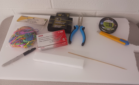

the supplies needed to build a robot hand are
  • elastic bands
  • styrofoam
  • paper clips
  • pliers
  • exacto knife
  • fishing line
  • hot glue gun
  • servos
  • arduino
  • marker

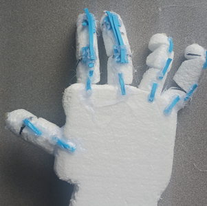

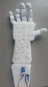

Step 1: Building the Hand

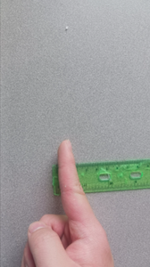

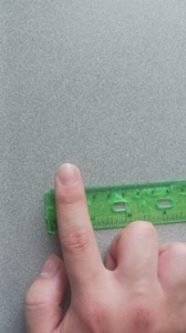

  • Measure the finger lengths and mark it into the styrofoam
  • Cut a piece of styrofoam according to the measurements.

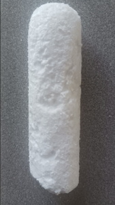

  • Sand down the styrofoam to look like fingers.

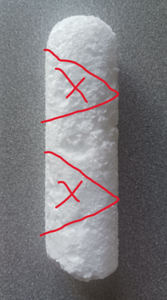

  • Cut the sanded piece into 3 parts to make finger joints.
  • Poke a hole through all the parts using a needle rod.
  • Cut a piece of foam the size of a hand and attach all the fingers to it.
  • Thread a wire through the holes from the top of the finger to the wrist and tie a knot to keep it in place.
  • Connect the parts with rubber bands, leaving some space between them.

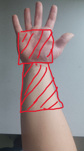

  • Cut another piece of foam to hold the servo motors.
  • Connect the wires from the fingers to the servo motors.
Step 2: Wiring
Attach the sensors to the hand. Connect the sensor wires to the hand and the strings. And ensure all connections are secure.
