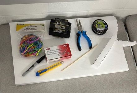

Materials
  • x1 Styrofoam Sheet 1x2 ft.
  • x20 Rubber Bands
  • x1 Paper Clips
  • x1 Sanding Block
  • x1 Fishing Wire
  • x1 Sharpie
  • x1 Thick Metal Needle (Skewer)
  • x1 Exacto Knife
  • x1 Plyers
  • x1 Arduino
  • x2 Servo Motor

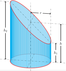

Step 11: How to Find Out How Much Materials You Wasted
To find out how much of the Styrofoam was wasted we made a python code to tell you the amount of waste. all you need to do is input the measurements needed.
Here's the link to python online ----> https://www.online-python.com/
To find out the waste you can copy and paste the code under into the online python.

#SemiSPHERE VOLUME
SemiSphVF1 = (math.pi * (4/3) * (sec1F1R**3)) / 2
SemiSphVF2 = (math.pi * (4/3) * (sec1F2R**3)) / 2
SemiSphVF3 = (math.pi * (4/3) * (sec1F3R**3)) / 2
SemiSphVF4 = (math.pi * (4/3) * (sec1F4R**3)) / 2
SemiSphVF5 = (math.pi * (4/3) * (sec1F5R**3)) / 2
SemiSphVTTF1 = CVs1F1 + SemiSphVF1
SemiSphVTTF2 = CVs1F2 + SemiSphVF2
SemiSphVTTF3 = CVs1F3 + SemiSphVF3
SemiSphVTTF4 = CVs1F4 + SemiSphVF4
SemiSphVTTF5 = CVs1F5 + SemiSphVF5
sec1F1H2 = float(input("Enter height 2 for section 1 finger 1: "))
sec2F1H2 = float(input("Enter height 2 for section 2 finger 1: "))
sec3F1H2 = float(input("Enter height 2 for section 3 finger 1: "))
sec1F2H2 = float(input("Enter height 2 for section 1 finger 2: "))
sec2F2H2 = float(input("Enter height 2 for section 2 finger 2: "))
sec3F2H2 = float(input("Enter height 2 for section 3 finger 2: "))
sec1F3H2 = float(input("Enter height 2 for section 1 finger 3: "))
sec2F3H2 = float(input("Enter height 2 for section 2 finger 3: "))
sec3F3H2 = float(input("Enter height 2 for section 3 finger 3: "))
sec1F4H2 = float(input("Enter height 2 for section 1 finger 4: "))
sec2F4H2 = float(input("Enter height 2 for section 2 finger 4: "))
sec3F4H2 = float(input("Enter height 2 for section 3 finger 4: "))
sec1F5H2 = float(input("Enter height 2 for section 1 finger 5: "))
sec2F5H2 = float(input("Enter height 2 for section 2 finger 5: "))
TruncatedCVs1F1 = ((sec1F1R**2) * math.pi * (sec1F1H + sec1F1H2)) / 2
TruncatedCVs2F1 = ((sec2F1R**2) * math.pi * (sec2F1H + sec2F1H2)) / 2
TruncatedCVs3F1 = ((sec3F1R**2) * math.pi * (sec3F1H + sec3F1H2)) / 2
TTruncatedCVs2F1 = TruncatedCVs2F1 - (CVs2F1 - TruncatedCVs2F1) #TOTAL CODE FOR SEC2 DOUBLE TRUNCATE
