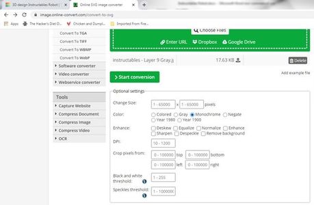

Step 2: Convert Images to SVG
Using an Online Image to SVG Converter, I made each layer into an SVG file.
Again, make sure to leave the image sizes the same. I chose Monochrome on import, although I am not sure if that made any difference.

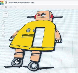

Step 3: Import Each Layer Into TinkerCAD
TinkerCAD has the ability to convert an SVG image and object in its design environment. During import, the objects were too large. I shrunk these to be 10% size, making sure each object was imported to the same size. Another tip during import was to make sure and DON'T MOVE the layers. This way, they all stacked in the correct positions.
Using TinkerCAD, I put all of the layers together, increasing the height of each layer by 0.2mm or 0.3mm offset. I planned to print at 0.1mm layers, so I chose 0.2mm for dark colors that would easily cover up the color beneath it. I chose 0.3mm for lighter colors, as it would print 3 layers.
After combining the layers, I then shrunk the combined object on the X and Y axis to achieve the spacing that I wanted for the screw holes. I did not shrink the Z axis, as I wanted this to remain in multiples of 0.1mm.
The last modification was to add the screw holes and the lightswitch hole.
Then, Export as STL
