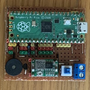

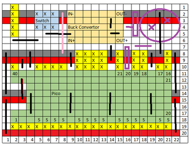

Step 2: Make the Control Board
The control board designed for this project is assembled on stripboard but a commercial board could be used instead though it may not be easily mountable on the main display. The board needs to be able to provide the ability to drive two servo motors, and the MAX7219 ICs via a three pin SPI interface . A Pico is used here, but ESP32 and Arduino could be used, code for these solutions is provided here. Provision is also made for a small loudspeaker.
The control card described can be powered by an external 5V supply directly or by a 7V-12V via the inbuilt buck convertor. If a 5V supply is to be used then the buck convertor socket can be bypassed.
The board has been tested with a USB power supply via the the USB socket on the Pico and found to work ok but the servos might struggle to operate correctly with the limited power.

Connect the LED arrays first then run the cable from the first LED array to the control board.
Vcc can be any red pin
Gnd can be any green pin

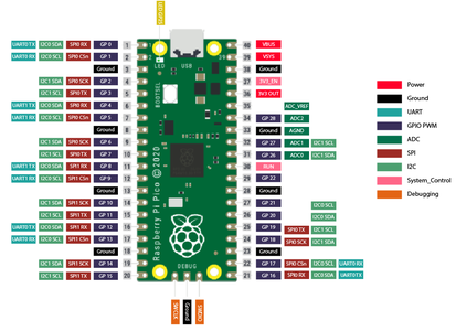

Din yellow pin 19
CS yellow pin 17
Clk yellow pin 18
The serial and common ground pins are physical pins 2 and 3.
The left and right servo connections are fitted to pins 21 and 22, with the orange/yellow wire over the yellow pin.
Removing the buck power supply before fitting the wires makes this easier.
