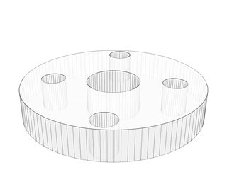

I designed the parts using Fusion 360 and included the design files here. I used Hitec HS-311 servo motors, but the idea is that you can choose your own standard size servo motor and build robot joints to your own specifications.

Slide the C bracket over the motor. The idle horn on the back side should be in place and it will be secured to the C bracket using M3 (8mm) screws. Secure the horn to the servo motor with the horn's screw.
Step 8:
Attach the shoulder servo motor to the servo horn on the C bracket. You can tighten the servo screw at this time.
