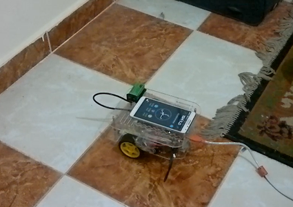

Step 1: Part I: the Robot Platform
The idea of this robot is to capture the values of the potentiometers
in the standard PC Joysticks and connect them as analog input to the Arduino. Each Analog button is connected to two pots, one that change its value when the button moves vertically and the second one horizontally. Depending on the change in values of the potentiometers the Arduino will control the motors.
Step 2: Assemble the Robot

1Sheeld captures the values of the sensors in your smartphone, in this project I’ve used the Orientation Sensor to detect the rotation of the robot on X-axis, and the Accelerometer will get the value of the acceleration of the robot in each direction
Step 6: Connect 1Sheeld

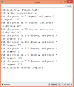

Step 7: Initialization Code
Remember that the values of the Orientation Sensor always change due to many factors (position with reference to earth and Sensor Quality ,..)
You’ll find this code with full documentation in this repository
https://github.com/MahmoudAyman/Robot-Tracking-

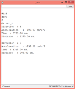

Step 8: Mapping Code
Step 9: Test
Step 10: Congratulation!
