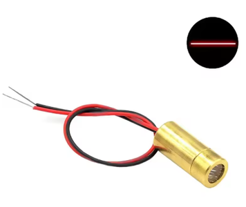

  2. 3 only 9mm line-lasers (fig.2)

For ease of positioning each beacon, I’ve printed a laser “cross-hair” calibrator.
Assembly Instructions
  1. Fit a 9mm line-lasers into the holes at each end of beam-angle arm.
  2. Wire each line-laser in parallel (red-to-red, black-to-black)
  3. Wire two 1.5 volt batteries in series to form 3volts.
  4. Apply 3 volts to the lasers and orientate the beams so they both produce vertical lines. Avoid direct eye contact ... Do not look into the lasers

The spinner houses:
  1. a 3 volt battery made from two AAA batteries soldered in series
  2. a 3 volt line-laser
  3. and a switch for turning the laser on/off
