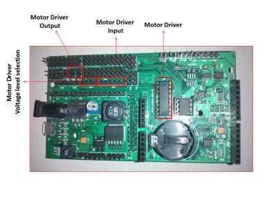

10 DOF IMU.
Temperature Sensor. Dual Bridge motor driver which can drive motors up to 1Amp.

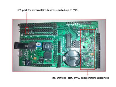

8 channel Servo Motor Diver which works on I2C.
RTC with coin cell backup provision.

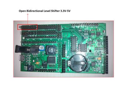

Open 5V-3.3V bidirectional voltage level converter.
Level Shifting for SPI, I2C, UART between Arduino Uno & Raspberry Pi.
Attiny85 micro-controller loaded with Arduino boot loader.
Header for ESP8266 Wi-Fi Module.
Header for HC-05 Bluetooth Module.IR Sensor for wireless remote control.
USB to UART Module.

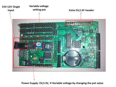

Single input source of 12V which power Pi and Arduino Uno It has one variable voltage regulator of 3A, a 5V/3A voltage regulator and a 3.3V/1A voltage regulator.
Two cell Lithium Ion battery charger with led and signal pins to monitor battery charge status.
Intensity variable LED controlled through I2C.
Its mechanical construction makes it compatible with most of the stack able Arduino Uno and Raspberry Pi shields.

We have used the bridge shield motor driver to connect to the raspberry pi instead of a separate motor driver. If you have a separate board or have made one then you can use pin numbers 4,17,22,23 from the raspberry pi GPIO header to connect to the motor driver pin numbers 2,7,15,10 .These connections have to be made as shown in pic
Finally, all of these have to be mounted onto a robot chassis (See picture to help you arrange the parts). Place the wifi dongle in the designated slot. Fix the bridge shield on the Pi and connect the two cell lithium ion battery to the bridge shield and your mechanical buddy is ready to roll!!
