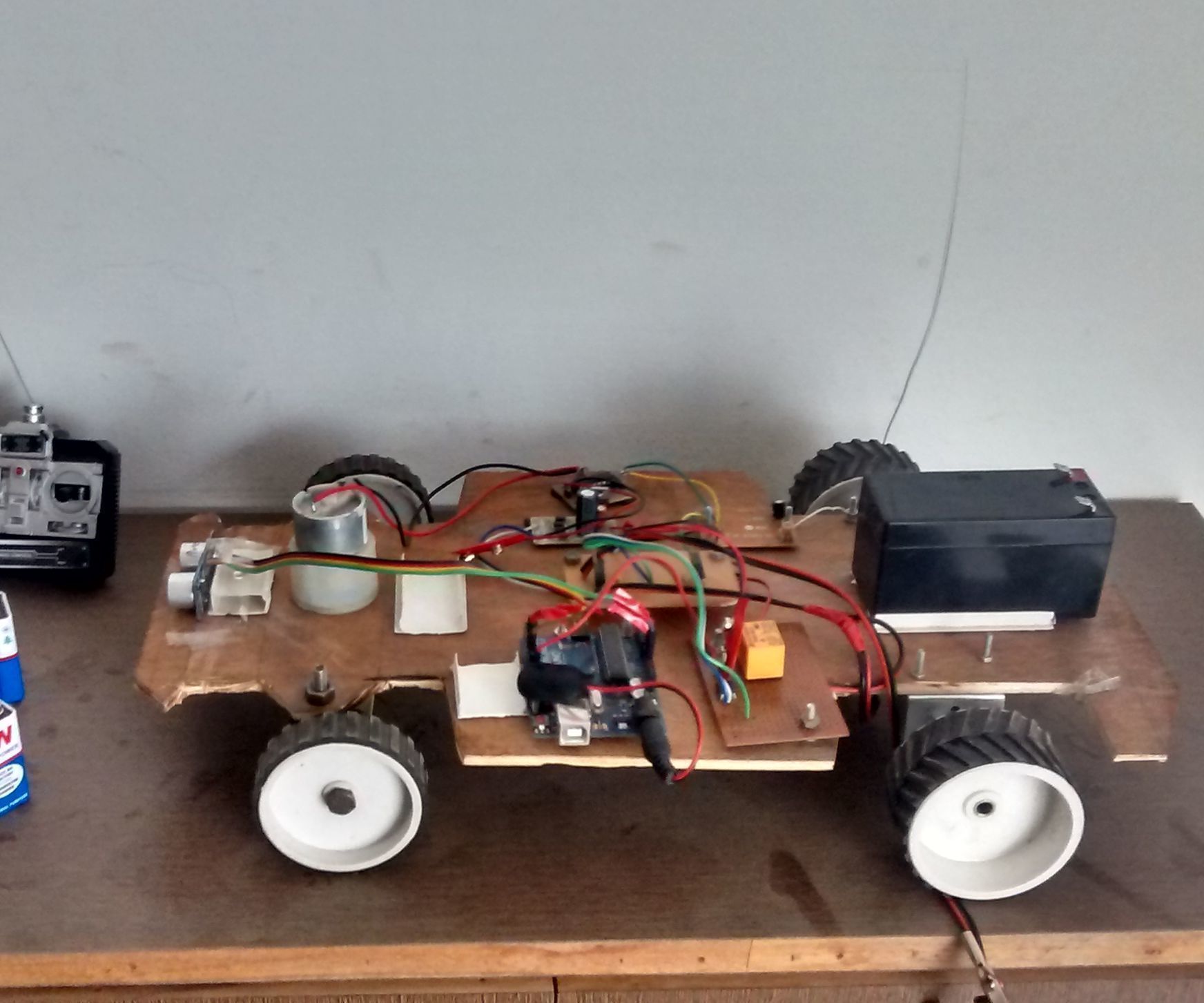

Step 1: Base Locomotive.
Take a large wooden plywood sheet of 7mm thickness of dimension barely equal to 50cm x 40 cm to make sturdy moving platform.
Attach four L clamps to its corners , Attach Two 100 rpm motors in one of 40cm edge and two bare gear motor heads on another.
The side which motors are heading is a actual side we will have robotic arm to be placed to maintain running force and wieght.
Attach four wheels to each corner.
This is our movable platform.

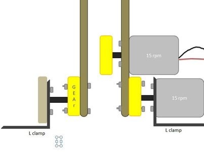

Step 2: ARM !!

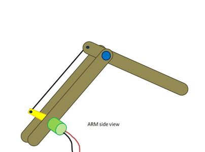

fig 1 shows, arm consisting lower arm having two strips of wooden base , and upper just a single.
fig 2 shows how arm base to be made
fig 3 shows how gears were modified to fit in frame
Also notice this design has two motor the one attached to the base L clamp moves arm lower hand and the one attached to the arm will move upper arm
This design is best when arm weight is important factor so here we just push every large weight(mainly motors) towards lower part of arm which is less moving.
screw the moving lower strip to the upper arm motor and upper and with equal length out to get a moving lever effect. Hope you understand. (the black line in fig 1)
