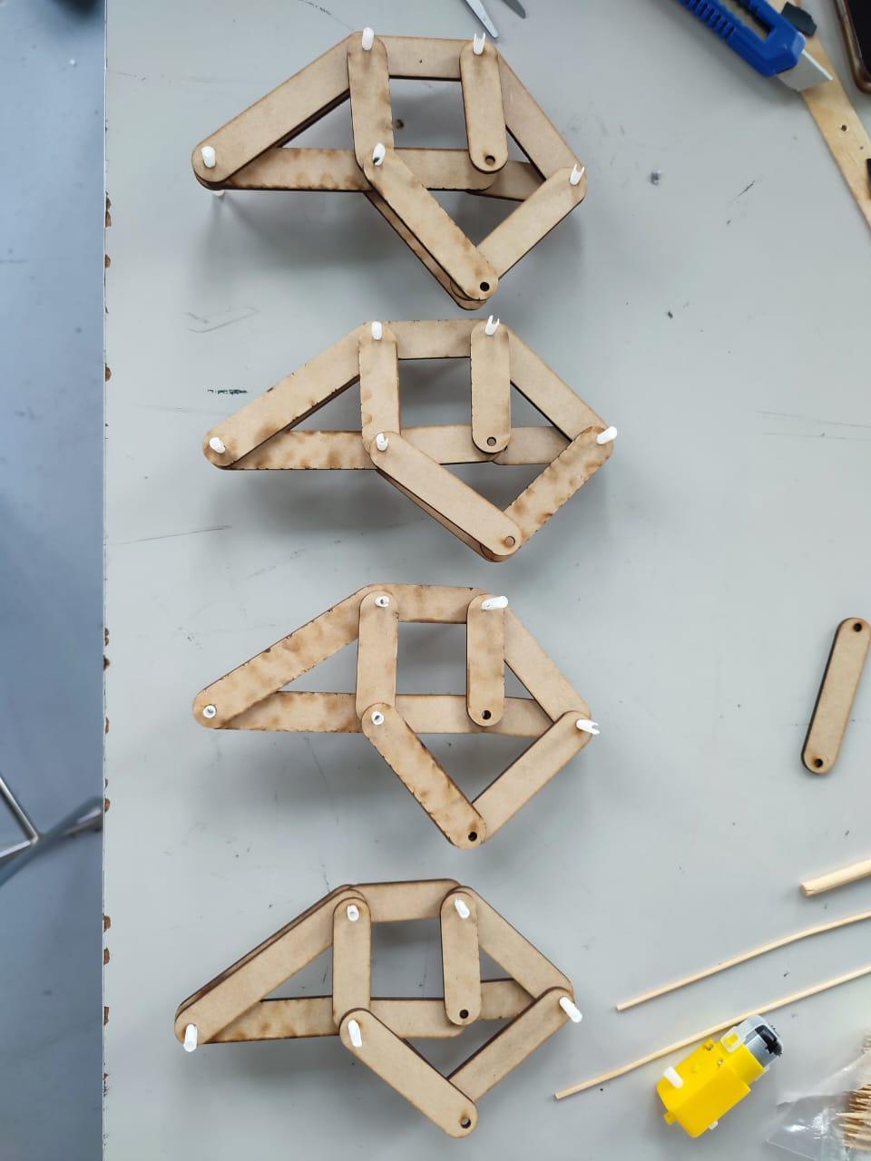

Step 1: Assembly of the Legs
After you have the pieces, you take 3 pieces of 8cm, 2 of 10cm (For better support, two 10cm lengths are placed on one of the legs). One of 6Acm and arrange them as follows, putting a union in each one

Then you add a piece of 6B and another of 8 and join them
Step 4: Finishing the Arms With the Legs
The previously mentioned process for the unions is the same, until making 4 equal legs.
