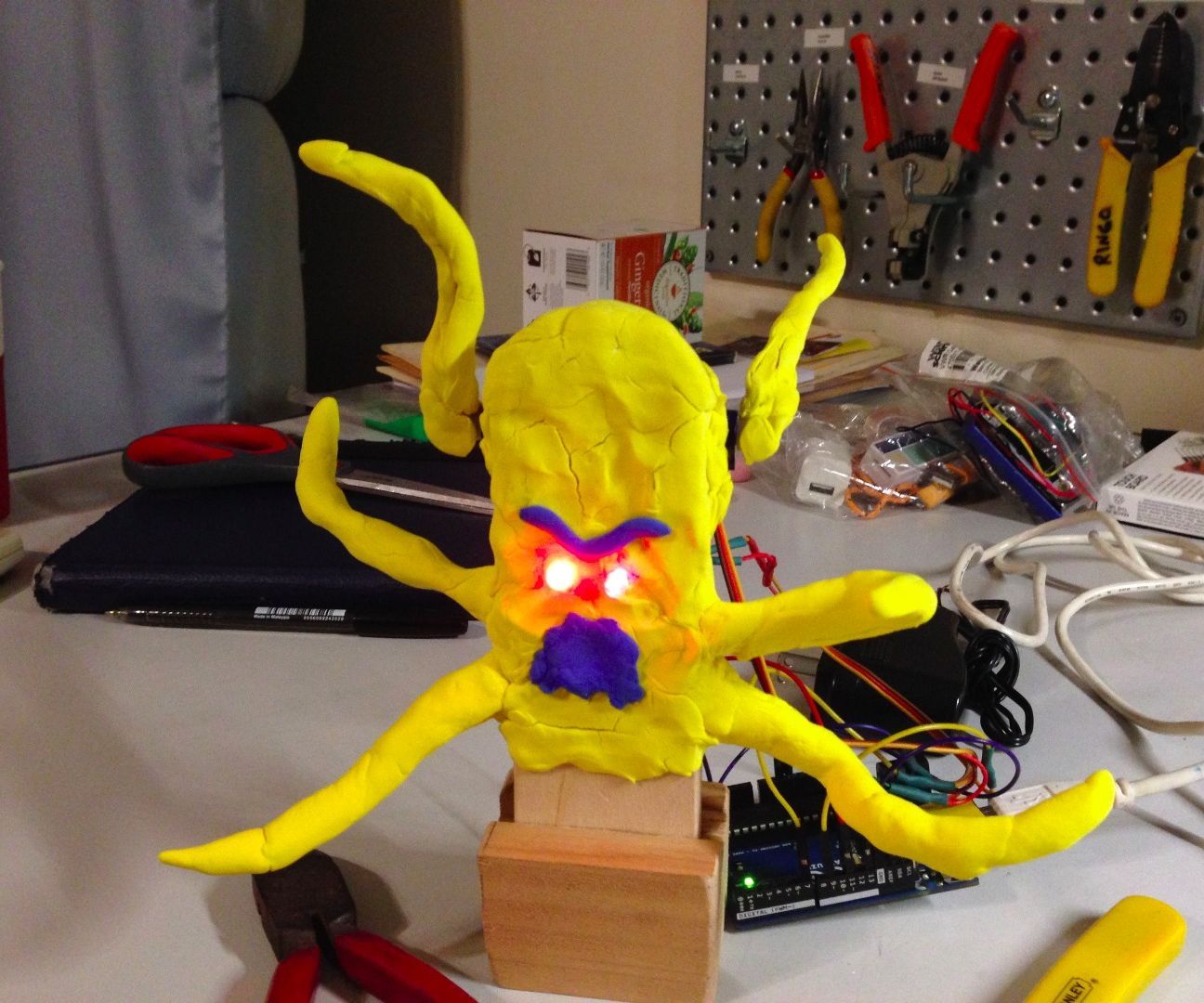

Step 2: Robot Base and Body
Create a base and body for your robot. I am super lucky and have access to a laser cutter and 3 mm plywood. Thus I designed my robot body with CAD and cut it out. You could to the same with cardboard. Make two holes for LEDs and one for the speaker. Keeping these close together can be helpful to reduce excessive wire lengths. Cut a rectangle for the LCD screen.
Screw your body onto the wooden base, and then attach the Arduino to the base. Be sure to leave the Arduino ports for computer and power accessible.

Step 4: Operating LEDs and Speaker
Add the LEDs and speaker to your robot. Use hot glue to stick everything in. Plug the black wire (for all 3 devices) into GND. Plug the positive speaker cable into pin 8. Plug the LED cables into pin 6 and 7.
