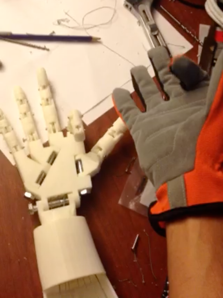

A glove that tracks the movements of the hand and then sends it via WiFi to a Raspberry Pi, which runs a program that then displays a visualization and transmits the movements of the hand in real time.
Accurate execution:
Our idea is to make it a glove that records the individual movements of the fingers, pitch and roll of the hand. This data is then sent to the Raspberry Pi/Laptop via the Wemos D1 Mini using a WiFi connection with TCP. In this connection, the Wemos D1 Mini is in AP mode i.e. it hosts its own WiFi network (as the school's network does not allow communication between the Raspberry Pi and Wemos). One advantage of this setup is that you can operate the glove where you want and are not tied to network connections. The collected data is processed by a Python script to send the correct signals to the individual servo motors of the arm to implement the movements. This involves converting the data from the gyro sensor directly on the Wemos D1 into position data, which is then sent to the Python script along with the movements of the individual fingers. This script then converts the position data into the positions of the individual servo motors, which are then controlled accordingly.

We first considered how to capture finger movements so that we could use them as a reasonable control for gripping. An initially inexpensive solution for this appeared to be pressure sensors, which we can also manufacture ourselves and thus save ourselves the unnecessary expense of purchased sensor technology.
Next up was an arm to translate the movement of the hand. A small 3D printed robotic arm seemed practical for this, on which I can freely indulge my passion as a passionate 3D printer fan. The arm was small and quickly printed, but very limited in its range of motion. The arm consisted of two joints, which not only interfered with each other, making it difficult to calculate the optimal position of the servo motors to reach a point in space, but were also very limited in their radius. https://www.instructables.com/EEZYbotARM/
After we, or rather the 3D printing Nerd, had finished the arm, we noticed the considerable flaw of the arm, which not only had a very limited range of motion due to its design, but was also very inaccurate and weak due to the use of cheap servos. We then decided on a version with larger servos and more freedom of movement (https://www.instructables.com/3D-Printed-ROBOTIC-ARM/). This was now a bit stronger and we additionally decided to develop a circuit board.
