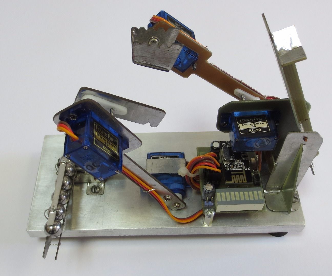

Step 4: Shock Sensor and Lifting Device
The target lifting device is made on a servo SG90. On the same device is an acoustic shock sensor implemented on a piezoelectric element. An interline resistor is installed on the board, which allows you to adjust the sensitivity to hits.
