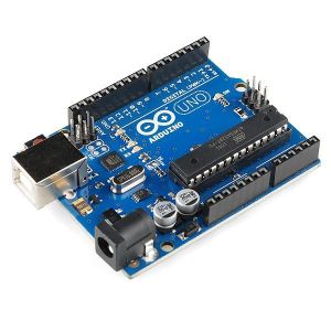

Material List
  • Arduino One (x1)
  • Button (x2)
  • Potentiometer (x1)
  • LEDs (x5)
  • 220 Ohms Resistors (x7)
  • Wire (1m)

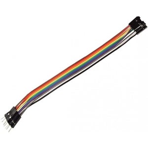

Step 2: Wiring & Connections
After soldering all the components to avoid the use of a breadboard, as it would complicate the integration of the components themselves, we proceed to connect the different elements of our system. On one side, both the buttons and the LEDs will be placed on digital pins. As we are working with a different serial monitor to the common one (9600), we should avoid connecting components to Pins 1 and 2. On the other hand, the potentiometer should be connected to an analogue pin.
Carefull
All identical components must be soldered in parallel (positive to positive and negative to negative) to each other. A 220 Ohms resistor should be soldered to the GND (negative) wire of all of them to control the voltage received and prevent damage to the components.
Summary
  • LEDs: Connected to digital pins (2, 3, 4, 5 and 6).
  • Buttons: Connected to digital pins (7 and 8) .
  • Potentiometer: Connected to analog pin (0).
