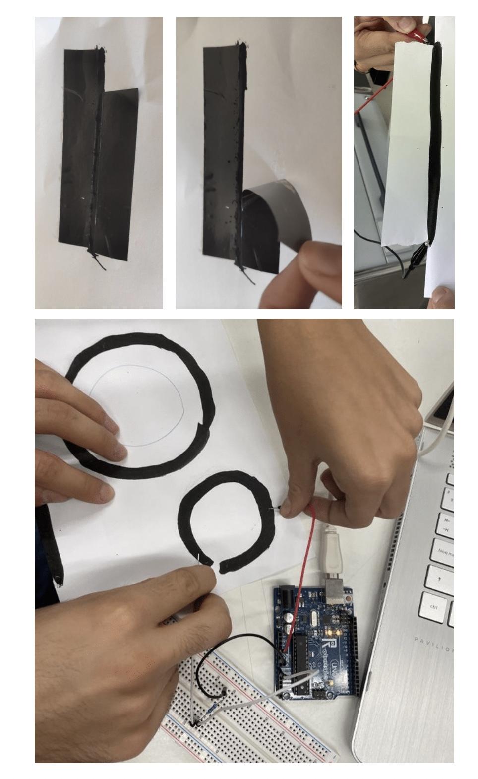

The first thing that came to our minds was to make something tactile, but without the use of screens. That's why we investigated the different options we could use and discovered conductive paints. For this, we were inspired by the projects shown in the images, from which we came up with the idea of making a potentiometer from the paint, to control the angle of rotation of the pieces.
To control which piece we selected, we were inspired by the functioning of Makey Makey, which is based on different ways of creating open circuits that, when you touch them, being us ground, the circuit closes and the action is executed. However, we came up against the problem that everyone conducts current differently, so we had to standardize the contact between components with pushpins.

Check if the paint is conductive before painting the diffuser. To test it, we recommend first drawing a line and, with a voltmeter and a wire connected to the arduino, see how much potential it drops. Then, we suggest to paint a line with the thickness you want for the panel (with two pieces of masking tape leaving the desired separation). And lastly, check if the perimeter of the circle is adequate to conduct and there is the necessary resistance (paint a circle of the desired diameter and thickness).
