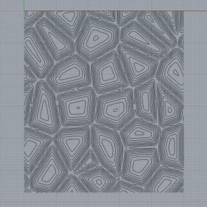

Step 2: Setting Up File in Rhino3D/Grasshopper
When you open up Rhino3D. We needed to measure the media size of our canvas before setting up out images. Once the dimensions have been set up with in the surface area of Rhino, we started programing and setting up out images in Grasshopper
Experimenting the images that we downloaded/created earlier and adjusting the programming in Grasshopper, we concluded that the Voronoi abstract pattern yielded the results for the contour lines.
