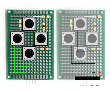

Step 2: Button Module
We have designed and soldered a module for the four buttons. The design in question is the one shown in the first image of this section. Subsequently, the buttons have been configured as input with Pull-UP resistors.
The result obtained after soldering is shown in the last two images of this section.
Once the module was soldered, we tested it with a simple program.

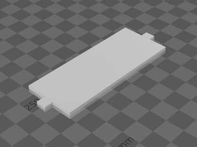

Step 4: Design
Once we have prepared all the components that are going to be inside the control box, it is the turn to design the box.
The design was created to have the joysticks attached to the bottom and both, the LCD and the buttons, to the top. The design has been thought with the intention of reducing costs in materials and printing time, so we get a large space to place the breadboard and the Arduino.

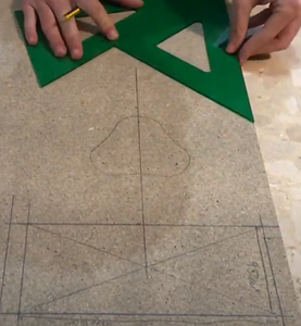

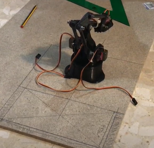

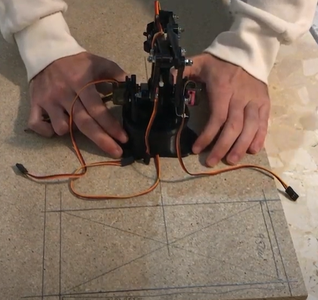

Step 5: Base Design
We made a wood base to attach the whole project (base and console). In this way we make sure everything stays where has to be. Finaly, we painted it in black to match the other pieces.

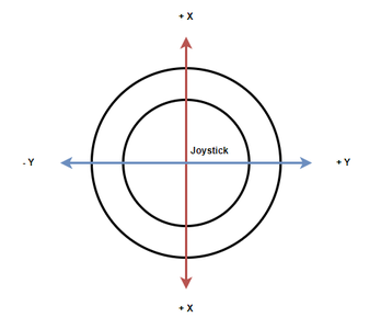

As for the joysticks, it is important to know which are their axes together with the range of values in which each axis is located but those values may change in your case. In this way we can configure the robot arm to move in a restricted area acquiring greater control over its positions.

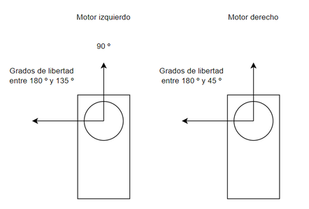

In the case of motors, it is important to place the data input pins to microcontroller inputs that support PWM for their movement. There are 2 types of motors, those with a rotation angle of 180 degrees and those with 360 degrees (the main problem with this type of motors is that we will not be able to know their position). In our case, the motors used have been the MG90S which are 180 degree motors. Therefore, we have initially placed the robot arm in a certain position in which we knew the angle at which the motors would be located to subsequently establish a range of possible rotation values (degrees of freedom) for each servomotor.

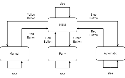

Starting from the code of the original project named at the beginning of this document, we have created a state machine. The state machine used in the programming is shown above. It has 3 main states from which it will jump as the corresponding buttons are pressed. With the intention of knowing the state in which we are and to provide a more friendly interface, we show the current state through the LCD screen. At first the robotic arm would be in Initial Mode.
If the robotic arm is in Initial Mode and someone presses the yellow button, it will switch to Manual Mode, in which the person can control the robotic arm with the joysticks on the control box. When the robotic arm is in this mode, if someone presses the red button it will return to Initial Mode.
If the robotic arm is in Initial Mode and someone presses the blue button, it will switch to Automatic Mode. In this mode the arm plays some programmed movements that you can change in the code. The idea was to recreate the behaviour of an industrial robot. If someone presses the red button it will return to Initial Mode.
If the robotic arm is in Initial Mode and someone presses the green button, it will switch to Party Mode. In this mode the arm simulate being on a party and moves the arm like a real party animal 😎. If someone presses the red button it will return to Initial Mode.
