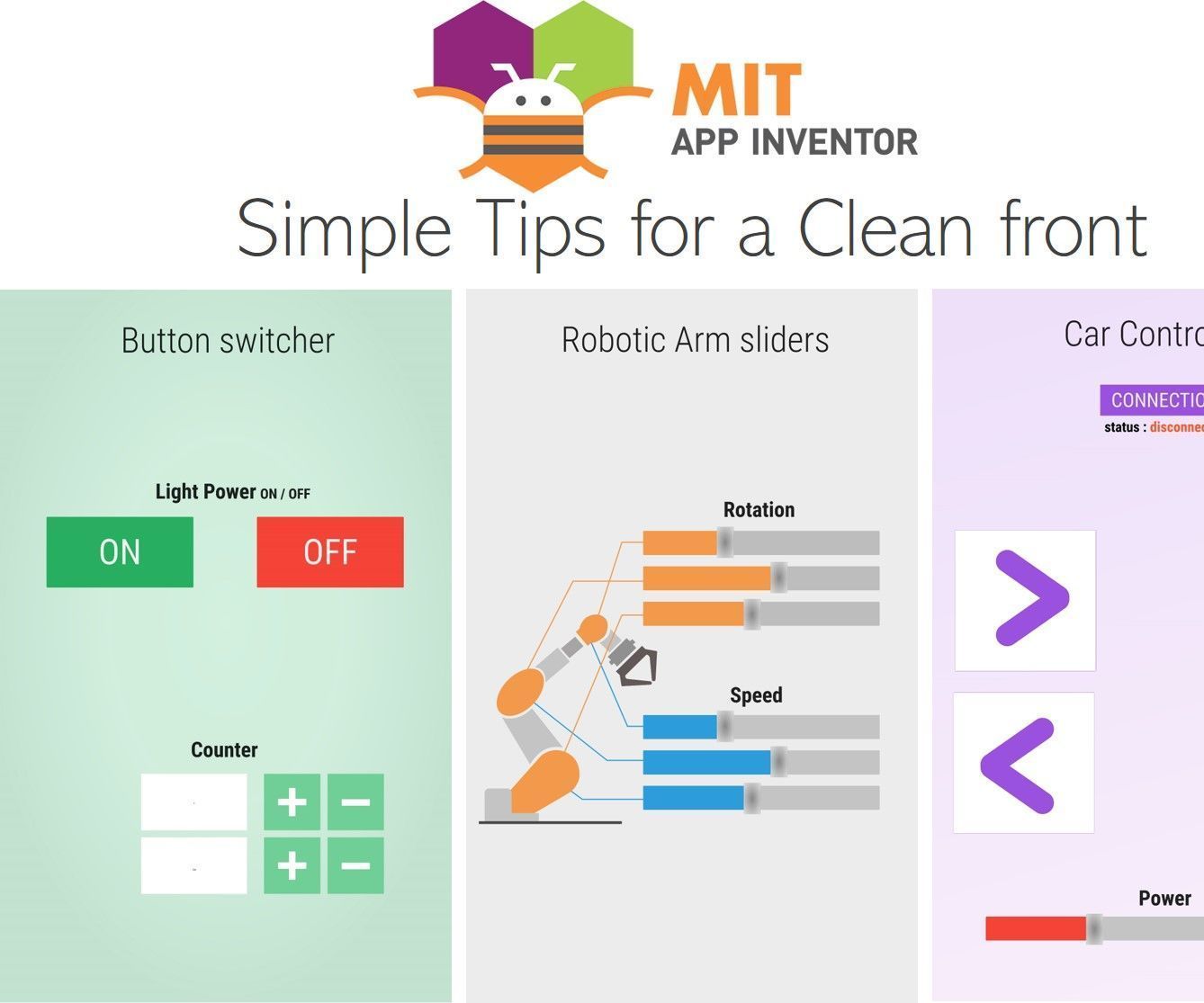

Step 4: Smartphone Application
The Application was made on App inventor 2.
We use 2 Joystick to control 4 Servos and 2 more Buttons to control the final Grip.
We connect Arm and Smartphone together by using a Bluetooth module (HC-06).
Finally, a saving mode allow the user to save up to 9 positions for the Arm.
The arm will then go into an automatic mode, where he will reproduce the saved positions.
