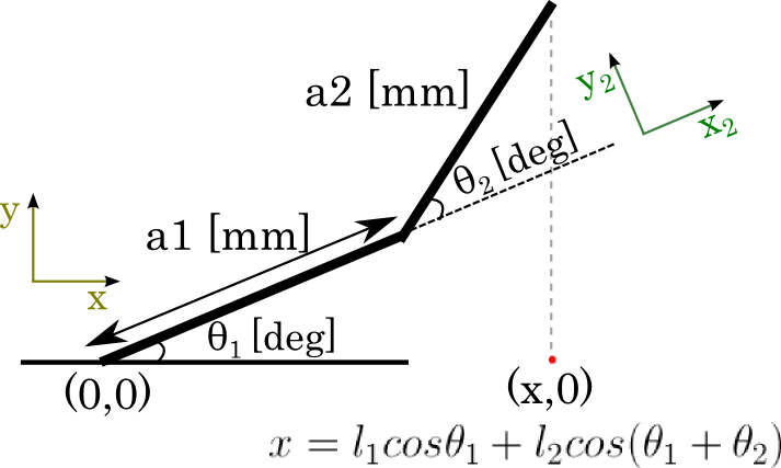

void get_xy() {
actualX = a1*cos(radians(theta1)) + a2*cos(radians(theta1+theta2));
actualY = a1*sin(radians(theta1)) + a2*sin(radians(theta1+theta2));

I was working through this and got a bit confused with the definitions of the variables since I took kinematics a while ago. This is a diagram for the forward kinematics part attached.
