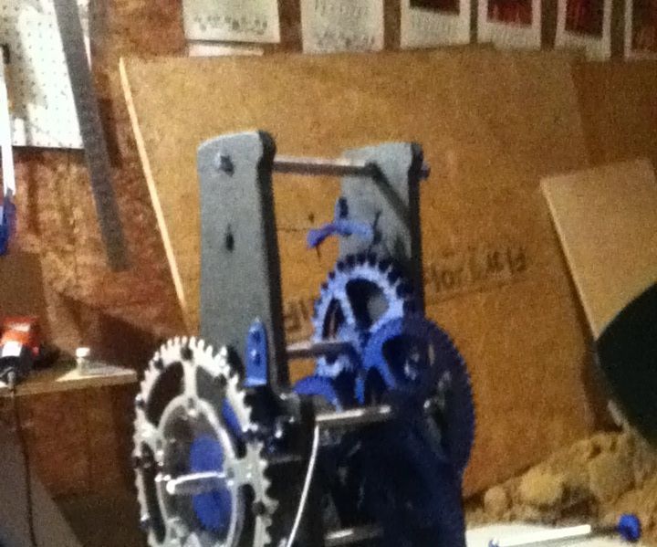

4. Dual Articulating wings: This part was probably the most fun to create. I wanted real life motion rather than just a single set of wing. I used Autodesk's Force Effect Motion app to design the wings. It was really col to learn how to use. So I made a quick plan as to how I was going to make this. It was mostly made up on the stuff I had laying around my house. I used a piece of plywood as the main back to support the motors, chains, and wing mechanisms. The wings themselves were made from PVC and metal as the main upper spine. I started by ordering two lazy susan bearings off Amazon. I then created wooden gears out of plywood with one gear having an axle attached that would stick out about a foot. The wooden gears were then bolted on to the lazy susans with were then bolted to the main plywood back. This entire mechanism is hard to describe so look at my pictures hopefully those will describe it better. For the wings to be moving, I used two little 120v AC motors set up inline with each other via a heavy duty chain. These motors get extremely hot so I had to put two heatsinks and two fans per motor to keep them cool. These motors were attached to sprockets which drove a chain, the chain was attached to a sprocket met on the gear axle that was made earlier. I then added a heavy duty bearing to help support the alignment of the axle. Check out my pictures for more explanation. The wings moved at roughly 6 RPM
