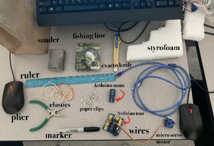

The supplies you need to assemble the robot hand is:
  • Styrofoam
  • Professional(optional) Fishing line
  • Glue gun
  • Marker
  • Elastic bands
  • exacto knife
  • Arduino uno
  • Arduino nano
  • paper clips
  • ruler
  • Sander
  • wires
  • plyers
  • needle
  • Data USB cable

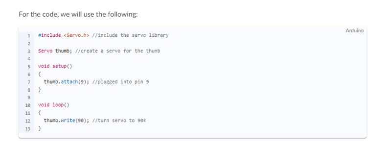

Step 9: The Code (tech)
The code for tech class is used to get the servos to turn to an 180 degrees in order for the fingers to work. We had used this code from our teacher.
