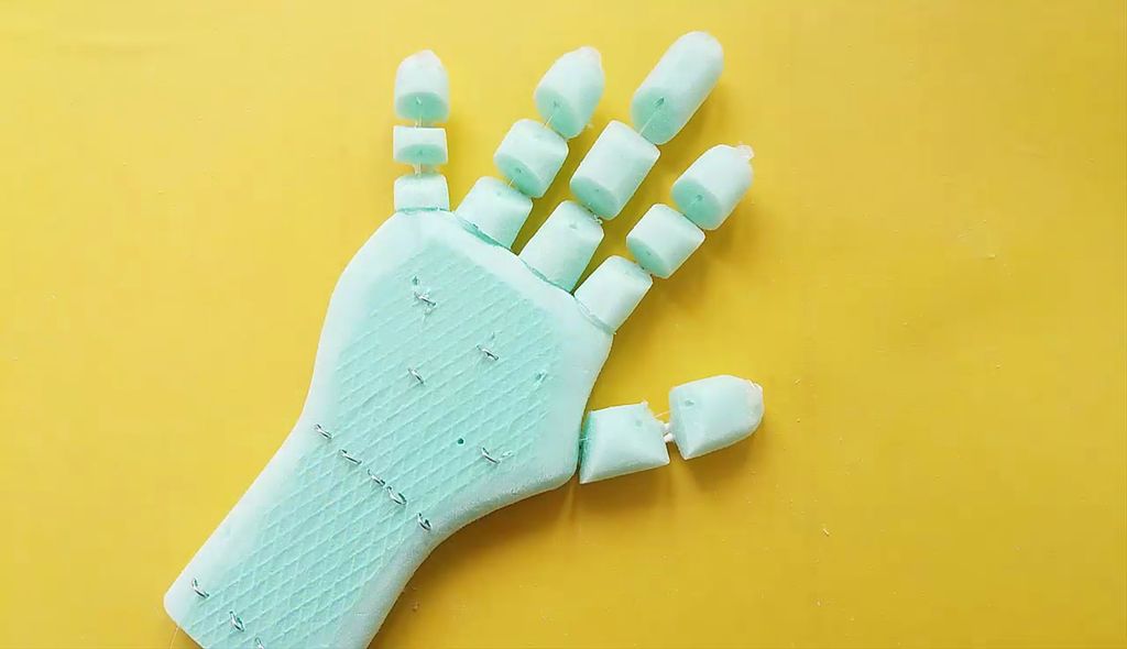

Step 3: Shaping and Sanding
Start off with a finger, Now using the sanding block you are going to want to slowly sand down the edges and smoothen the finger, Now you are going to want to cut the fingers into three pieces depending on what finger you are doing. Afterward you want to shave each piece of the finger into a 45 degree angle so that it looks like your models finger when bending. (Fingers should still be labelled for no confusion)
Step 4: Sowing the Sections and Fingers
Each finger should now have 3 sections besides the thumb, the thumb should have 2 sections.
Now you are going to want to use the needle and fishing line to sow through each section of the finger so they are more stable and not loose.
Make sure to tie a knot at the end of each finger to ensure stability
Now you can sow your fingers to your hand and wrist
Make sure there is enough fishing line at the end of the wrist ( At least 3 inches)
Now you are going to want to tie the fishing line to the needle and poke the needle through the hand and pull it down the wrist (Make sure 3 inches at the end also repeat for all fingers)
