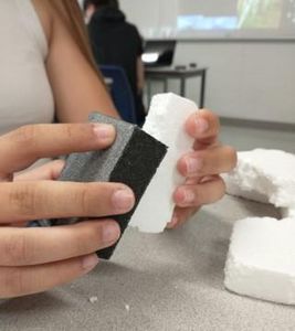

Step 2: Sanding
The next step that must be done is sanding down the rectangular prisms that were just cut out, into 'fingers'. This step will make them more realistic and mobile. Sanding is only for the fingers, the palm should not be sanded.
Sand down the rectangular prism so that it is round on the sides. When finished, it should look like a cylinder, with a hemisphere on top. Then collect measurements for radius.
When sanding, be sure to not sand too much or too little off.

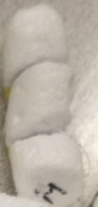

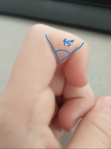

Step 3: Cutting a 45° Angle
In order for the fingers to move properly, there must be two 45° angles cut into the finger. A humans finger also has these angles when fully bent.
  1. Start by cutting a straight line through the fingers to make it three sections. You should be cutting at where the model's joints are, so they must be used for this step. This should be done by marking off the joints where the models joints are, and cutting from that.
  2. Next, take these three sections for each finger and cut a 45° angle. The top with the hemisphere should only have one angle on the bottom, the middle section should have two angles, and the bottom should have one angle at the top.
  3. You can gently sand to make smooth, but not take off any access Styrofoam. It may be good to label the fingers again so pieces don't get lost.
Cutting the angles may be done either by eye (using the models fingers) or by using a protractor. Our group did it by eye.

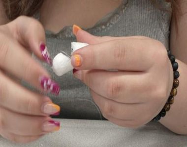

Step 4: Sewing and Assembling
One of the most important steps to do is sewing. This is what makes the fingers able to move. You will need a needle and fishing line for this step.
  1. Begin by collecting the pieces that were just cut on angles and put them together for sewing. If the angels were cut correctly, it should look like the finger is slightly bent when they are pushed together.
  2. Next, thread the fishing line through the needle and tie a knot on the other side. You are now ready to start sewing.
  3. Start sewing your finger by going in from the top and connecting all of the parts. Go out through the bottom and make sure it is able to bend by pulling the string. Repeat until all fingers are sewn.

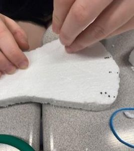

  4. Then, with the excess thread that you have, take your forearm/palm and sew the finger through once. Pull it through and rest it on the forearm. You should be able to estimate where the fingers need to go.
  5. After that is done, the excess string must be secured into place. This is done by using paperclips.
  6. Cut the paperclips with plyers. You should be able to get three semi-circles out of one paper clip by bending it in a certain way. It is probably good to have around fifteen semi-circles just in case some are lost or broken.
  7. Then insert the paperclips into the forearm securing the fishing line down. Two clips per string is a good amount.
Now, when the strings are pulled the fingers will move and look like they are bending.

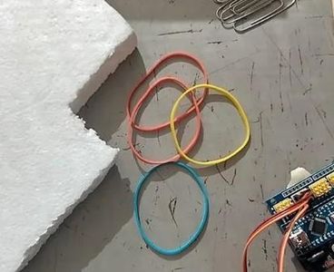

Step 5: Attach Rubber Bands
Fishing line isn't the only thing that will make the fingers bend. Attaching rubber bands will help the fingers to return to their resting position.
  1. To start, cut rubber bands approximately so that it will tightly connect the two joints in a finger. There must be two rubber bands per joint, so four rubber bands for each finger except the thumb which only has one joint.
  2. Next, hot glue the bands into place.
  3. The rubber bands could possibly not be efficient enough to pull the finger back. In this situation, folding up a piece of duct tape and gluing it on the back of the finger might help it.
