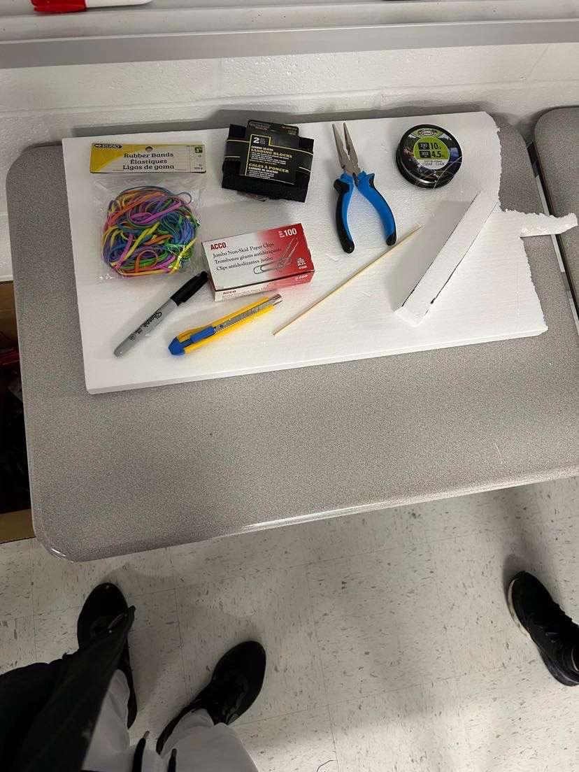

The project proposed by my exploring technology teacher, consists of building a robotic hand, I was tasked with finding the volume and waste for each finger by coding with python, so I was not involved with making the hand.
The materials needed for this project includes: Arduino Uno, 2 servos, 1 foot^2 of foam, box cutter, sanding block, pliers, fishing line, marker, bag of elastic bands, paper clips, blank piece of paper, and a ruler.

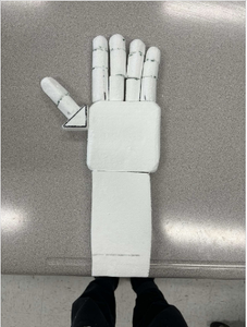

Step 1: Measurements
Firstly, you would trace out your hand on a blank peice of paper and measure each section as demonstrated in the picture. Lastly trace the measurements onto the foam for the next steo. (Be sure to make the length and width the same for simplicity)
Step 2: Cutting
After measuring each section of the fingers, cut them out with the box cutter. If done correctly it should look similar to the pictures above.
Step 3: Measure Height 2
After each section of each finger is cut out, make a 45 degree cut on the ends on the top and base of the finger, while making 2 cuts on the middle. The end result should be a hollow joint where the sections should connect. If bent each section should align to create an arc. Lastly measure height 2 of each section (From the cut to the bottom of the finger).
Step 4: Sanding
After all is done, round out all the harsh edges, making it more aesthetic or more hand like.
Step 5: Connect the Hand
After all is said and done, use hot glue to connect the base of each finger to the palm.
Connect each finger using hot glue, but instead using a elastic band form a joint, and hot glue that into place. At the end all the sections should be connected.
Step 6: Thread Fishing Line
Cut paperclips in half to create the pathway for the fishing lines, make a lane for each fishing line to connect with the corresponding finger.
After that, use a needle and make a hole in the middle of the finger, and hot glue the fishing line at the end of each finger.
Step 7: Adding the Servos
Once the fishing line are all connected, add the servos in a "V" formation on the forearm, then wrap the fishing lines to the ends of the servos. (Make sure the lines are tight)
