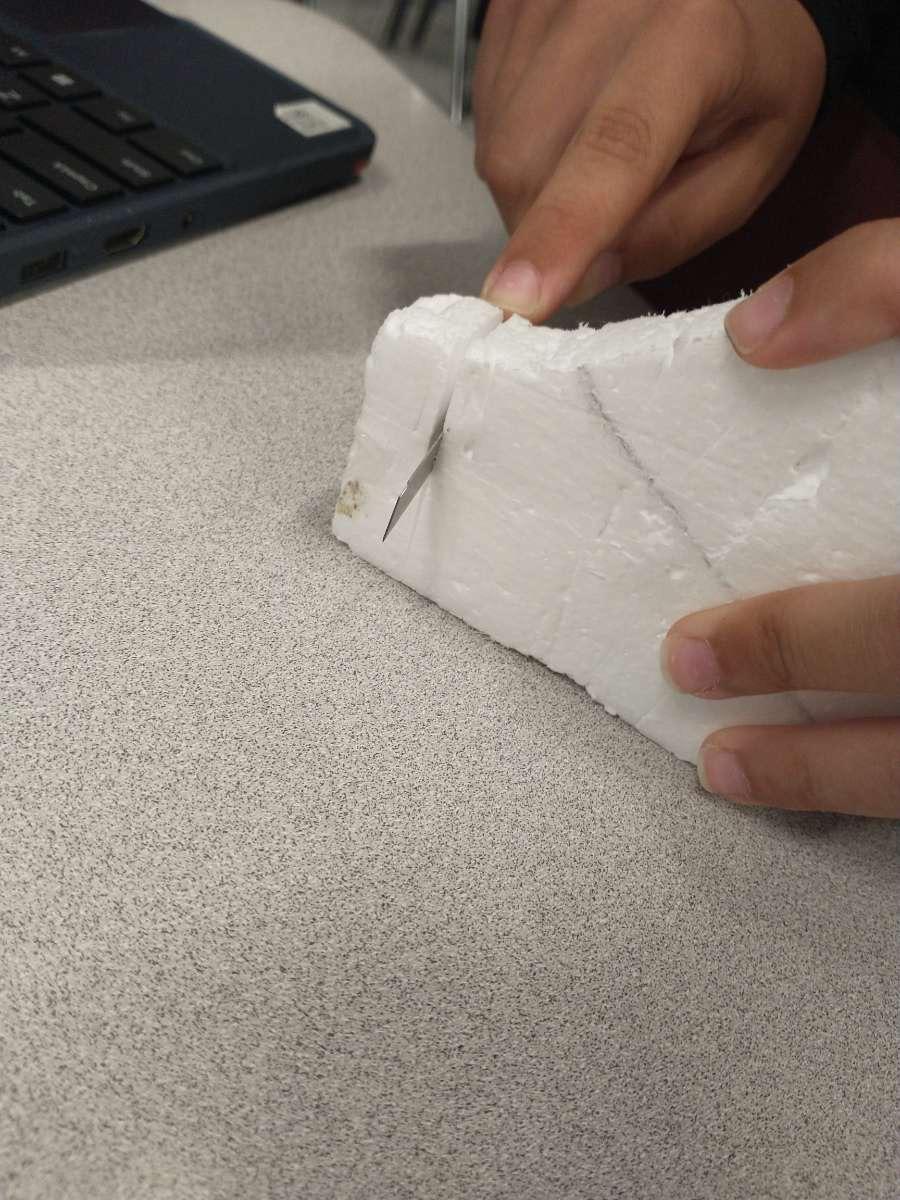

Step 6: Cut the 45 Degree Angle
We then began to cut three segments into each finger and 2 segments into the thumb representative of a hand. We needed to use a utility knife to cut the segments on a 45 degree angle While cutting the finger segments we cut one 45 degree angle in the bottom segment, two 45 degree slices in the middle and one 45 degree slice again at the top. The same process was completed for each finger and also the thumb using, one 45 degree slice on the bottom and one on the top.

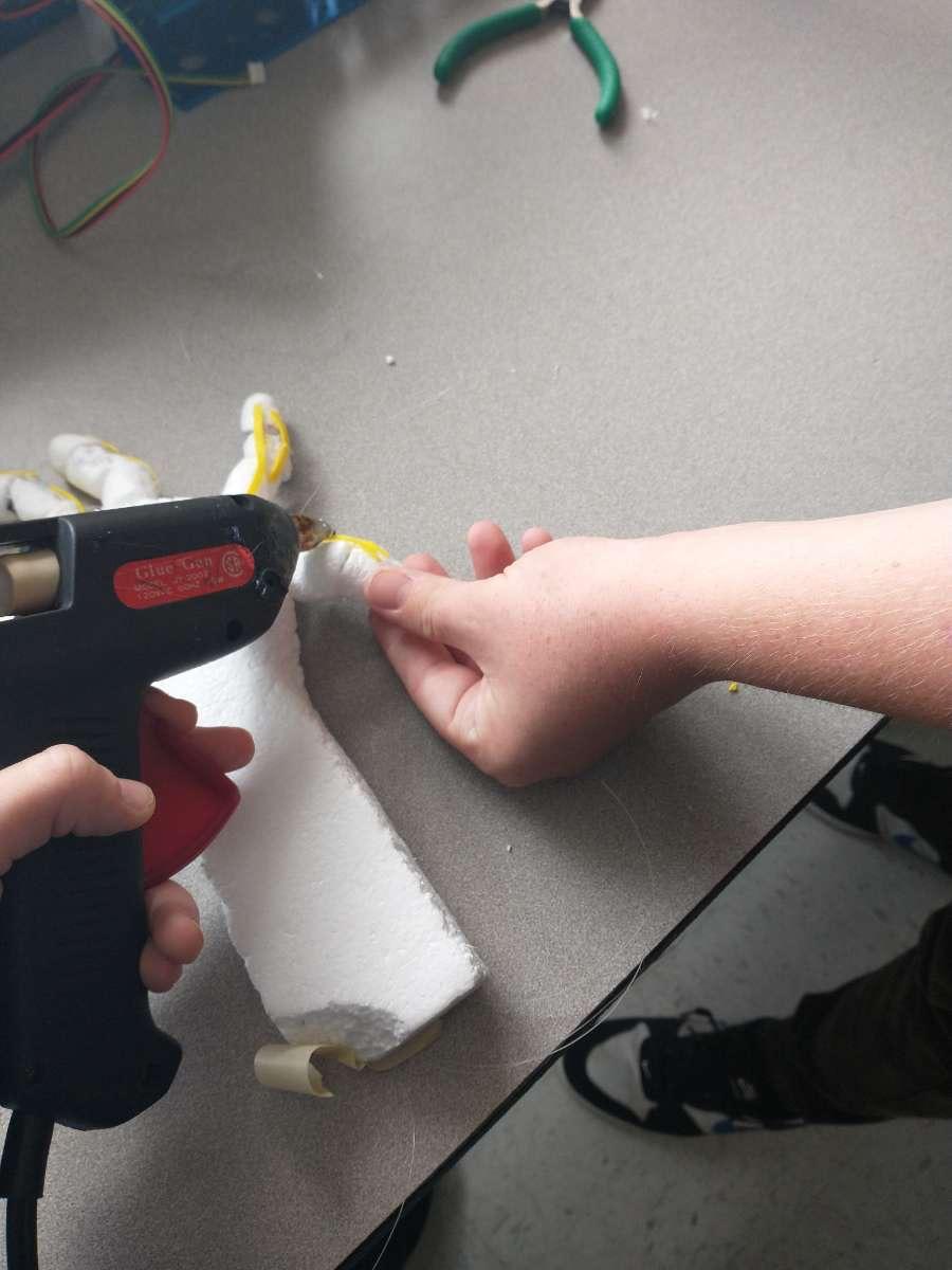

Step 10: Glue the Rubber Bands to the Fingers
To get the fingers back into place after they have been moved we used tension from stretched rubber bands to move them back into place .The steps we followed to do this were cutting the rubber bands into equal strips then we put the fingers strait and glue the rubber band pieces on to keep the tension taught.
