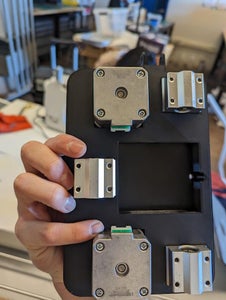

Step 2: Assemble the Raft
- Align the bottom and top of the Sliding Base with one another
- Insert the feet for the linear bearings in their respective locations, aligned with holes
- Use the M4x50 screws to attach two linear bearings to feet 1
- Use the M4x35 screws to attach the third linear bearing to foot 2
- Align the stepper motors with rod inclusion to their respective locations, attach them with the M3x35 screws

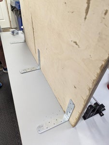

Step 6: The Backing
Notes Before Proceeding:
This part is the most difficult, as the backing must be perfectly aligned so that the optics are able to dispense using the Threaded Disc. I cut the backing myself out of spare wood, but you could get the wood in a variety of different ways.
- Attach the Drink Dispenser to the backing, aligned with the top of the wall using M4 Wood Screws. My backing was 1/2 inch thickness, but change the length to fit your backing
- Align backing with the Raft, making sure that the optics are aligned with the Threaded Disc
- Use L-Brackets and M4 Wood Screws to attach the backing to the table. Additionally, the piece of wood I used and brackets weren't fully perpendicular so I used washers for correction

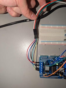

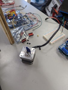

Step 7: Electronics
- Align the Arduino Board and Breadboard to the back right hand corner of the table, mimicking Table End #1's location
- Merge the Stepper Motors with Rod Inclusion to one another, connecting their respective points with the second driver
- Thread the wires for the third stepper motor through the hole drilled in Step 3 and bring them under the table till they reach the Arduino. Attach the wire to their respective points on the first driver
- Solder wires onto the contact switch (Top=Blue, Middle=Gray, Bottom=Green) and thread the wires under the table through the hole made in step 4. Connect them to their respective points on the breadboard, then afterwards on the Arduino as seen in the photo above
