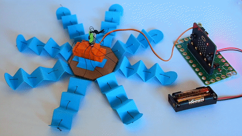

Step 1: Making the Tentacles
  • Cut out a tentacle
  • Fold it in half with the template markings on the outside
  • Tip: You can save some time by folding the tentacle in half, then cutting the rounded top part
Step 2: Poke the Holes
  • Use a sewing needle to make the holes in the marked locations
  • Make sure to go through both layers of paper
Step 3: Invert the Tentacle
  • Fold the tentacle in a zig-zag
  • Unfold the tentacle, then refold it inside out so the template markings are on the inside
    • You can also leave the template markings on the outside if that's your style!
  • Optional: add glue when you fold it in half to hold the two layers together (it's not necessary since it holds its shape pretty well without glue)
Step 4: Cut and Knot the Thread
  • Cut a piece of thread around 12" long
  • Double or triple knot the end of the thread
  • Thread the needle
Step 5: Sew the Tentacle
  • Use the holes you made in step 2 to sew the thread through the tentacle
  • Make sure to start from the rounded end of the tentacle, and on the outside of the zig-zag fold
  • Add a drop of glue (or tape) on the knot to make sure it doesn't pull through the paper
  • Double check that the knotted end is on the rounded side of the tentacle, and the extra thread is on the opposite side
Step 6: Make More Tentacles!
  • Repeat 7 more times until all 8 tentacles are finished
  • Set the legs aside for now to let the glue dry
  • Are you regretting making a robot with 8 legs? Just be glad it's not a centipede!

Step 11: Attach the Tentacles
  • Glue a tentacle to the bottom of the cardboard base
  • Only glue the last folded section of the tentacle (the one without a hole)
  • Make sure the thread doesn't accidentally get glued to the cardboard
Step 12: Add the Other Tentacles
  • Repeat for the other 7 tentacles
  • Try to keep the threads from getting tangled

Step 14: Attach the Servo
  • Glue the servo holder to the cardboard base of the Octobot
  • Note that the servo itself isn't centered on the body—the servo's shaft is what should be approximately centered
Step 15: Making the Axle
  • Cut a piece of straw about 3/4" long
  • Use the needle to poke a hole through the straw at about halfway between the top and bottom
  • Poke another hole (this one only needs to go through one wall) close to the top of the piece of straw
Step 16: Check the Straw Size
  • Put the straw onto the servo shaft
  • Since straws come in all different sizes, it may be too big. If that's the case, put a very small piece of tape around the servo shaft to increase its diameter
  • The straw should fit snugly on the shaft
Step 17: Attach the Thread
  • Sew one of the pieces of thread onto the straw
  • First go through the middle holes, then up out the top
Step 18: Do It Again
  • Repeat this 7 more times until all 8 pieces of thread are sewn into the straw
    • It's best to do this one piece of thread at a time to avoid them getting tangled or twisted
  • Check that the length of the thread between the straw and the tentacles is roughly the same
    • You can check this by pulling the piece of straw up to check that the threads are all roughly the same tensions
Step 19: Attach the Axle
  • Push the straw to the servo shaft, making sure it's snug (if it's loose, the shaft will just spin inside the straw without turning the straw itself)
  • Make sure the tentacle are all fully extended, then tie a big knot where the threads exit from the straw
  • Trim the extra thread
Step 20: Connect the Circuit
  • Connect the servo to the Bit Board at Servo Pin 1

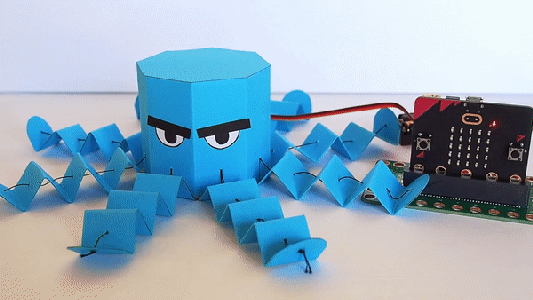

Step 23: Put the Body On
  • Put the body on
    • The thread should slide into the thin cutouts in the body
    • The servo wire should go through the larger cutout
  • Optional: You can add a bit of glue to secure the body to the cardboard base (I didn't in case I wanted to access the inside)
Step 24: Give It a Face
  • Give your Octobot a face!
  • Touch the logo and shout "BOO!" to make Octobot retract its tentacles!
