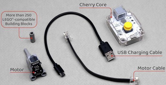

For this project, you are going to need a Cherry Tart kit.

What is the Cherry Core?
Cherry core is the main power source of our project. One of the cool features of Cherry core is that it has an onboard microphone that detects sound impulses. Clapping hands or snapping fingers are the two potential sources of sound impulses that stimulate the Cherry core which increases toys' interactivity for kids. With each impulse, Cherry core slightly turns the motor for a short period of time so kids can control how fast their motorcycle is going by clapping faster or slower.
