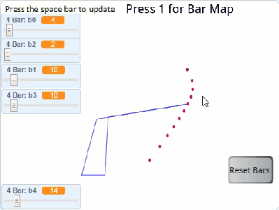

Puncher battles are a fun classroom activity that guarantee that students will innovate to win! By tuning the bar lengths of their puncher's 4-bar linkage, students can take advantage of "inverse leverage" to throw fast punches to knock their opponent's block off.
Step 1: Before Finishing Your Build, Tune Bar Lengths to Optimize for Punching
The above bar ratio of 2:4 means the fist's speed and distance traveled increases significantly
