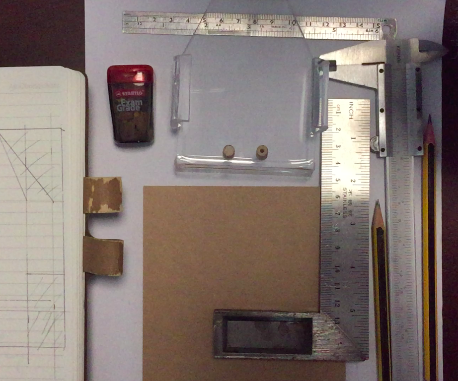

Step 2: Bracket for the Cooling Fan
Bracket for the cooling fan was made using U-channel Aluminum (one and a quarter inch wide).
The mounting holes for the cooling fan could differ depending on model made. My case here it happened to be 3/16 inch from each end. An M5 hole is drilled for mounting the fan at the Aluminum bracket.
The opposite side of the U-channel will see a mirroring plane for M3 holes. Refer Figure 5.
Quick check if the marking are symmetrical or else it will not fit the opposite side.
Once all marking is in place, it will be ready to be cut.
A plier is used straighten the side where the cooling fan will be mounted.
A guiding hole is punch using a steel nail prior to drilling.
Mounting a parts into place will be a resemblance of figure 3.
