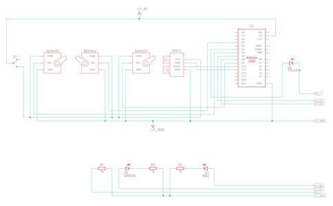

Step 1: Create the Circuit
Above is the schematic of the circuit in this project.
For extra clarification, here are the steps broken down:
Arduino Uno:
Before adding any extra components, the Arduino must be wired to the breadboard.
A jumper wire will be used to allow the Arduino to give the - rail ground. As for the + rail, the slide switch has one leg connected to it, and the middle leg is connected to the Arduino in the 5V pin. Jumper wires will also be used to connect both + rails and - rails together.
Servo Motors:
Each micro servo has 3 input pins: Positive, Negative and Signal.
Positive and negative pin of all 3 servos will be connect to + and - rails of the breadboard respectively. The signal pin of servos will be connected to 3, 6, and 9 pins on the Arduino Uno.
Ultrasonic Distance Sensor:
The distance sensor has 4 pins: Gnd, Trig, Echo, & Vcc.
Gnd needs to be connected to the - rail and Vcc needs to be connected to the + rail.
In this circuit, Trig is connected to pin 11, and Echo is connected to pin 10.
Breadboard*:
Place 3 differently coloured LEDs (in this case red, green, and yellow) at an equal distance apart.
Each LED has an anode and a cathode.
Every cathode will be connected to the - rail with a resistor in between**, and the anodes are connected to the 8, 7, and 5 pins respectively.
*Extra jumper wires were added on the breadboard to make the circuit more well-organised. They are not necessary.
**Resistors ohm amounts can vary depending on the voltage used by each LED. In this circuit, the red LED used a 1k ohm resistor, while the green and yellow LEDs used 330 ohm resistors.

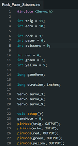

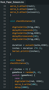

Step 2: Coding the Circuit
Attached is the Arduino code for the Rock Paper Scissors Project. It can be downloaded and then uploaded to the Arduino.
To understand the code, here is a breakdown of the three main functions used:
checkDistance:
Check distance does exactly what its name says, it checks the distance using trig and echo from the distance sensor.
If & Switch (Case) Statements:
An if statement was used with the condition of when the distance from the nearest object is less than 5 inches. If this condition is met, then the switch statement will be executed. Very similar to if statements, switch statements execute different areas of code depending on the value of a variable. The variable used here is "gameMove", a variable that is assigned a random number from 1-3 (rock, paper, or scissors).
