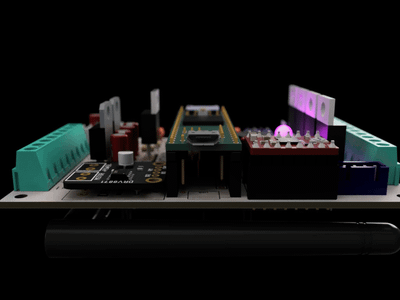

But if you want a PCB you'll need more than a hand drawn schematic : you have to design it on your computer. For this I've chose Autodesk Fusion, which lets you design electronics circuits and use the 3D model of the PCB in your mechanical assembly. It's great to have everything in one place ! Moreover to design this FC one of the main ressource I used is the Landing Model Rocket - Series from BPS.space, and he's using Eagle, the software on which Fusion Electronics is based. (By the way I really recommend you to watch it, you'll learn many things !) But nothing's stopping you from using something else, like KiCad, which is really well documented and free to use.
In your PCB design your going to use components, which are objects mapping a symbol (the drawn item you use in your schematic) with a footprint (the physical shape the component will have on a PCB). You can also add a 3D model to your component if you want to check that nothing is intersecting and make some renders (most of the simple components already have it). Then you're going to connect each component with power and the microcontroller, using virtual wires. This video from BPS.space explains pretty well the basics, and if you want a short explanation of the software you can use this video. You can also use the schematic I provide on this GitHub repository and delete things you don't want, or add some ; it's better than starting from nothing.
Step 4: Route Your PCB
Now that you have your complete schematic, you can start designing the real PCB. You have to place the footprint of your components on the board, so you first need to draw your board. You can make a circle if you mount it horizontally, like the FC from Lafayette Systems, but I needed to put it vertically because of all the components I have. For this you have to know that the manufacturers often have some special offers on the first board you order, only if the size is below 100mm*100mm. At the same time it also has to fit you airframe, in my case the maximum width I could use was 75mm. So I had to fit every components in 75*100mm, which was a bit tricky but not impossible.
I recommend you to first place the connectors you need (screw terminals at the top and the bottom for me), and the microcontroller in the middle. You can then place the components for which you don't have much choice. For example, the mosfets must be near the pyro terminals, and it's better to put the voltage regulators near the battery connectors. The passive components that are connected to those should also be near (to minimize the routes length), so let some room for them. You then place the rest of the components around the microcontroller. In general you'll want to put small components like resistors at the end. Be aware that you'll always be able to move components afterwards, so try things and see if they work. When you're finished, you can start routing.
The routing is not complicated, but can be quite long. You have to make the links between all the pins of your components (just like you would do with wires on a breadboard). You need to consider that higher power needs wider traces. For signal traces, 0.25mm is fine, for low power (sensors, stepper motor driver), 0.5mm, and for high power ones (battery, pyro channels), 2mm is good. About pyro channels, you'll see that 2mm may not be enough depending on your use (more in the testing step).
At the end if you're using Fusion you can click "push to 3D PCB" and you'll have a nice model of your FC !
